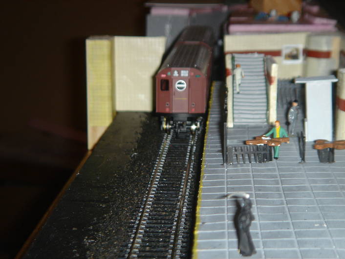

LION likes to use these plastic thingies (called plastic canvas in the fabric store) and cuts them to the shapes that him wants. Him figured him could make a stairway. Subway stations need stairways, and I am happy to have found something that will work.
I’ll show more of how this works as I built it out.

LION, it strikes me that if you didn’t want the sides of your stairs to look like latticework, your plastic canvas would make an excellent template for cutting and gluing stringers for realistic wood stairs.

I dunno…in my experience the NYC subway tends to go with solid risers, even in a lot of the elevated stations (not all) - for one thing, keeps the lunkheads from catching their feet under the stair treads and tripping. Helps keep trash from piling up under the stairs too, especially in an enclosed stair well. Not saying there aren’t applications for this (good for wood exterior stairwells, with a “wood” siding sheet hiding the lattice, but it may not be ready for prime time MR yet (MRH, OTOH…[:P]).

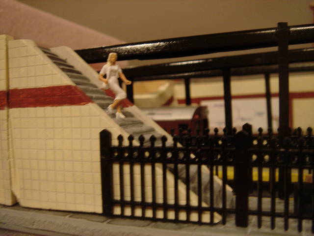

Finally, the reason for the Grim Reaper on Mr. Beasley station platform is quite obvious from the second image, with the lady figure in white (and heels!) picking her way down a steep stairway with NO railings or handrails - I know some people who could barely navigate three steps without a railing, now image 1000s of people walking down such a stairwell during rush hour - even better if its wet from rain. You’d never get the blood stains out from the bottom of the landing…
Exactly. That is all I am using the plastic canvas for in this case. I already have walls glued to the sides of the steps. I still need to put the cover over the top of the stairs, and add lighting to the stairway. These stairways will rise from the platform level at the south end of the platform up to the mezinine level. At track level I will add the bench wall and from the bench wall there will be a doorway to access the space under the stairs. On the NYC subway these doors are labled with a room number (not unlike the way that spaces are numbered onboard warships), the name of the department that is responsible for the space and the phone extention of that department.
Since this station has two island platforms, there are two stairways, and the doors will be labled for the “SIGNAL” and “POWER” departments. This location on the railroad is also “Chain Zero”, the point from which all other locations on this line are numbered. The northbound tracks would be A1 and A3, the south bound tracks would be A2 and A4.
