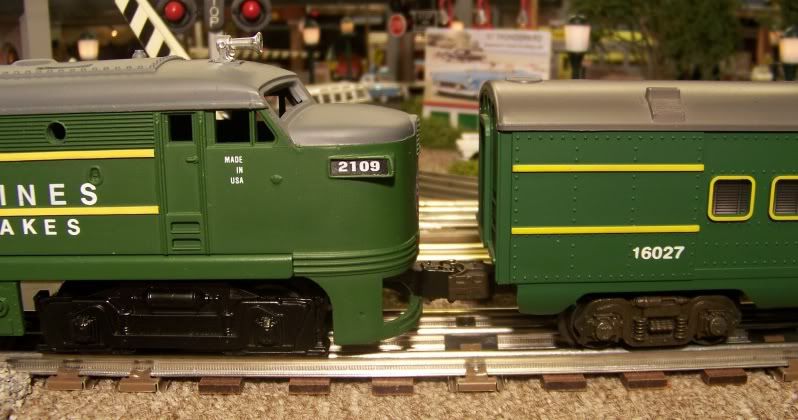

When Lionel moved to Michigan they reissued the 2400 series cars with Michigan cities. I’m not sure how closely the colors match the origionals, but when I aquired a set of the Michigan cars I wanted them to be pulled by postwar Alco diesel engines that would match the same color scheme. At the local hobby shop I looked at the Tamiya Color paint rack and came up with AS-23 LIGHT GREEN and AS-27 GUNSHIP GRAY2. The gray color is real close and the green is close enough for my eye. I used Woodland Scenics Gothic R.R. rub on letters and numbers that match the font style of the passenger cars. The yellow stripes I printed on adhesive backed paper on my inkjet printer. Finally I used Krylon matte finish to seal the numbers and provide an even flat finish that matches the origional. The results are more than adequate to my eye and I’m quite happy with the result.
I think your Postwar Alco look realy nice. Job well done.
