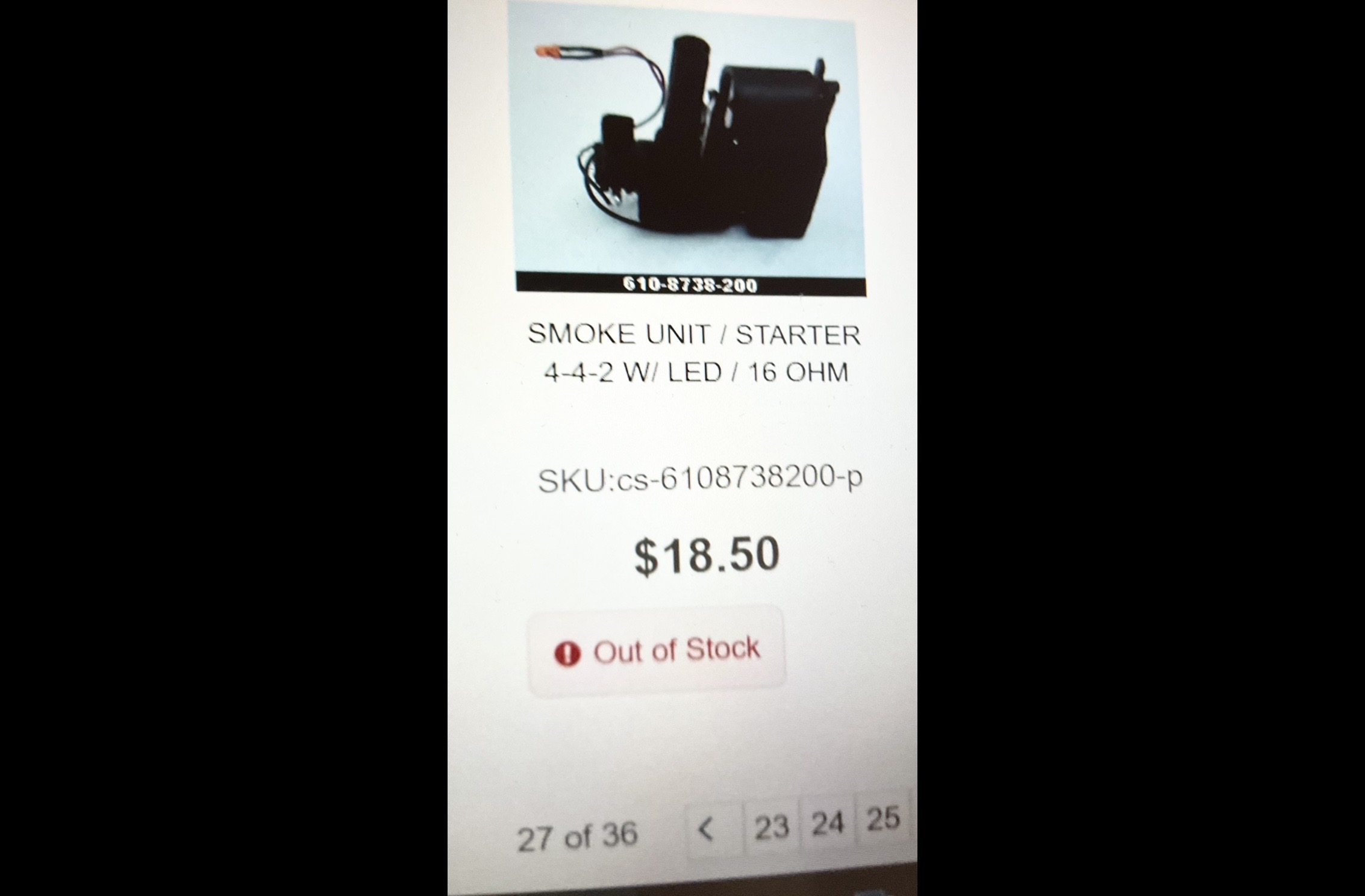

Well, I went to the Lionel website and searched smoke units. After looking at about 80 items, I found the exact smoke unit I have been talking about. Unfortunately, it is out of stock. I am writing this on an iPad and have a picture of the unit on the iPad also but don’t know how to post it.

For those of you who may have been reading this thread I just found a picture of the smoke unit I have been talking about on the Lionel website.
Yeah, I looks to me like a self-contained and irreparable unit, when it goes bad you have to replace it. Best of luck with the hunt for a new one!
