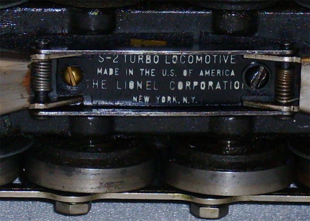

Lionel 671 loco says "Turbo" on bottom builders plate.

I found this engine on ebay, and it strangely says “Turbo” instead of turbine on the bottom plate of the engine. Could this be a rare variation, or a factory misprint? I don’t know alot about these engines but just seemed wierd to me.
It does say “TURBO” - it looks like the real thing…:
Rob
looks to me like the “plate” was made on a dymo labeler and the screws are different. clearly not original.
This is the 1947 version of this loco, since there is an e-unit lever sticking up through the top of the engine. The lettering on the collector plate that you are referring to was standard for that model. The screws look like they could be replacements.
Turbo is correct. The screws are not. They should be binding head screws with flatish heads. The sloppy lettering could be from overzealous cleaning with mineral spirits or maybe oil with some kind of detergent was used on the axles.

I have a 671 and looked. The plate is identical except the lettering is much crisper. The service manual also shows the plate with turbo on it.
