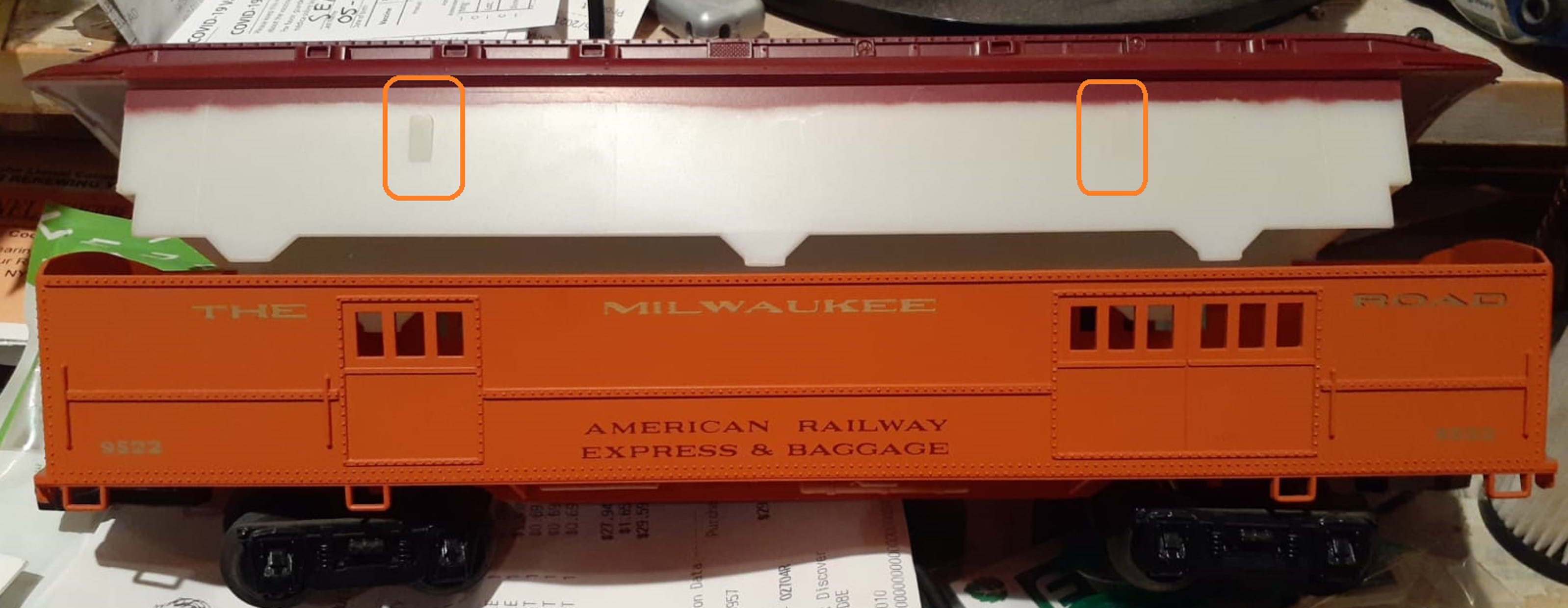

But really, here is the Milwaukee baggage car. It has one bulb, and 4 tabbed windows to press in for unlocking the roof & window piece. Same method as all of the other cars.
We should add that if the roof’s never been off it’s going to be a bit “sticky,” so you’ll have to work it a bit.
