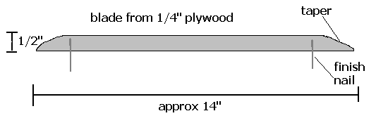

I use my giraffe car on a section of GarGraves and with a strip of 1/4" plywood, about 12" long and approximately 1/2" wide instead of the metal blade to activate the ducking mechanism. In other words, I matched the height of the original blade as compared to the outside rail. I used two finish nails to attach it to the plywood beneath the ballasted track. I tapered the ends so the yellow bar will slide smoothly up over the homemade blade. For the tell tail pole, I used a block of wood, painted gray, and drilled a hole to accommodate the base of the pole. The block of wood is screwed to the plywood also. This keeps the giraffe’s head down longer than the original device that slid under the track. Just be sure your other equipment doesn’t get hung up on your homemade blade. I painted the homemade blade black. Hope this helps!

No I didn’t need any additional weight in the car. I have the finish nails glued into the homemade blade but just friction fit into the plywood of the benchwork, so it is adjustable. I can raise or lower it to fine tune it, and the taper on the ends is gradual, which helps. I did have a clearance problem with my center cab 44 ton diesel, so the blade is perhaps just a bit farther away from the outside rail than the original metal blade. Here is a diagram that might help: http://yourpage.blazenet.net/jprampolla/blade.gif

Thanks Joe. I appreciate the sketch.
Any chance you could re-post your homemade Giraffe mechanism online or in this forum? I just picked up the Giraffe car at a train show and I need to rig something up to work with FasTrack. Anyone have any suggestions specific to FasTrack? Thanks in advance.
