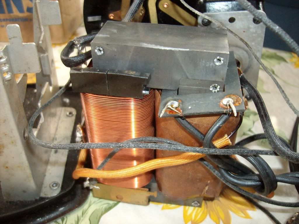

I’m going to open her up this afternoon and replace the cord. I’ll post some images and ask for help too. Hope this is the right thing to do. At any rate, it will be an adventure for me and maybe for you too, vicariously.

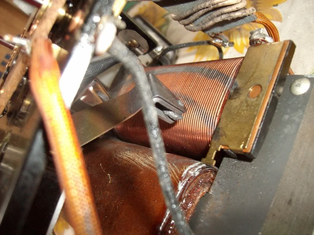

I replaced the cord & rollers and tried to clean up the coils which had the rub marks form the old rollers. Used “PureTronics” contact cleaner from All Electronics to remove some of the build up.
When I plugged her in, the voltages all checked out ok within less that a ½ volt variance of what they should be. But when I hooked the KW up to the track, my 2025 would hardly budge. It just barely moved forward, then neutral, then reverse with another slight movement.
I suspect some “cold solder” joints in the KW introducing too much resistance. You can see from the images that whoever did some repairs must not have had a powerful enough soldering iron/gun. Much of the solder is lumpy and otherwise looks un-good.
Does that make sense? How do I track down something like that? What else could it be?
