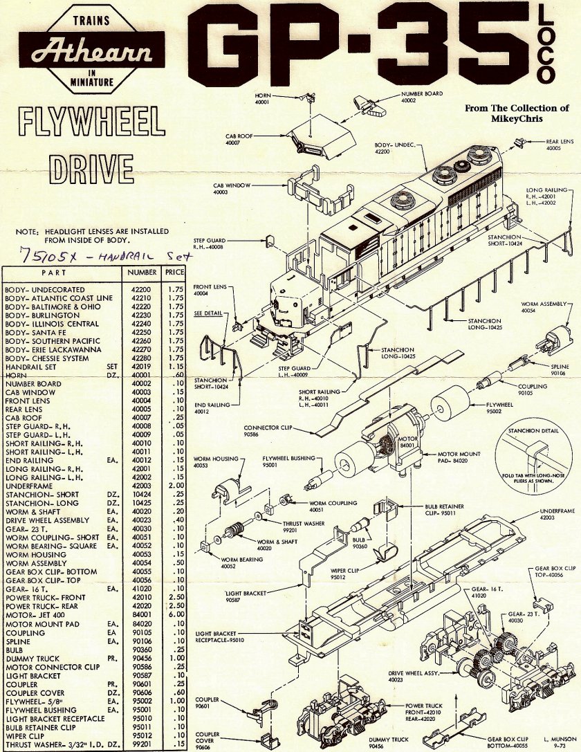

Here is the older BB W/ outside bearing trucks.
http://www.hoseeker.net/assemblyexplosionAthearn/athearngp351973.jpg

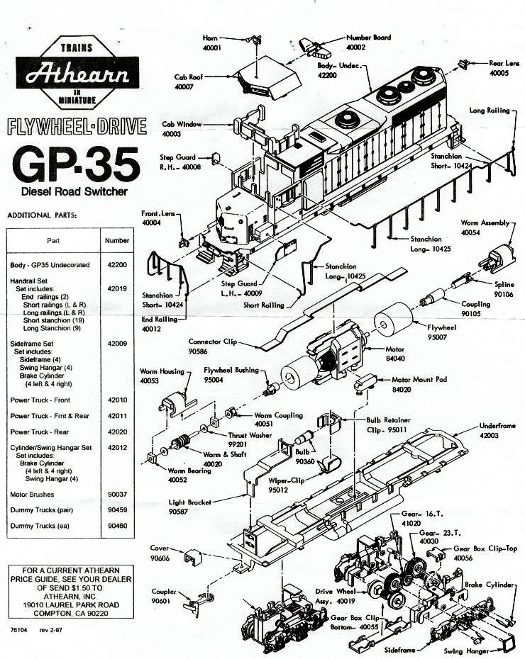

This is the newer BB W/ inside bearing trucks.
http://www.hoseeker.net/assemblyexplosionAthearn/Assembly%20Explosion%20Athearn%20GP35%201997.jpg
Google the P/N, lots of choices. Ebay might have the best deals.
