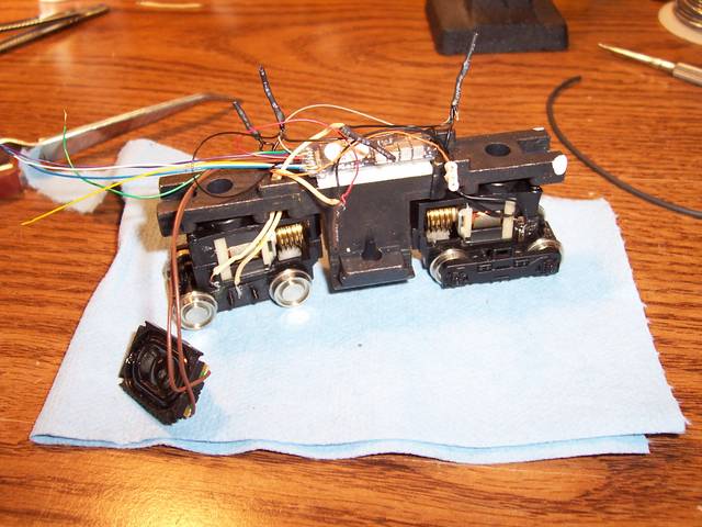

One of the best running little engines in my collection is a dual motor 44 tonner. This little beauty has held up long and well. But like the story of the goose that laid the golden egg, I wanted more! The idea of using a Lok Sound Micro has been peculating for several months. Lok Sound has superb motor control and great sound. The Micro is pretty small, so it should fit, I thought. But, what about the motor control and the tiny dual motors?
I put the issue out on the forum. While several people had some well educated theories, no one appeared to have tried this venture. So, this week I decided to lay into my gold egg laying goose and see what I could do inside. Here’s the pictures and the results:
Picture 1–The patient prepared for surgery.

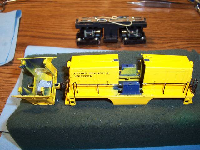

Picture 2–All of the component parts spread out for examination.
Picture 3–Cutting the motor leads and rewiring each of the motors.
Picture 4–Test fitting the decoder just prior to running the engine on the test track. Oops! I wired the motors in opposite directions! [:I]
Picture 5–Where do I put the speaker? The shell fits snug over the decoder and the underside of th
OMG !!! That’s some serious cramming you did there !!! [:O]
Congrats, kudos and a double high five for getting everything stuffed in there and working so well. When I first opened this thread, I thought you were going to ask if it COULD be done … I wasn’t expecting it could, really ! I didn’t think there was any way you could cram a speaker in there as well. Great job.
Mark.
Thanks, Mark. It took some very small pliers & screwdrivers and caused me to lose about a year’s worth of eyesight due to squinting and eye strain. [8D]

great installation , great tutorial , great demo videos !
and the amazing thing is it sounds great even with a very small speaker
what size is the speaker and is it self baffled (enclosed) ?
thanks !
Thank you, ereimer. The speaker shape is in a rectangle and almost the size of the top of the 44 tonner’s roof. It would have fit perfect inside the ceiling if not for the light inside. This is the original speaker which comes with the Micro. It’s not baffled, but I’m guessing that the positioning against the cab wall may produce the effect.
Proper baffling requires an air-tight enclosure. But who cares, it sounds great whatever you did!
