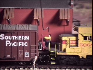

The uncoupling tool works by simply hooking the tool (at the last 90 degree bend) onto the air hose of the car or loco on the left and pulling it toward you so the coupler swings away from the other coupler. You must have a small amount of slack to make it work. It takes a minute or two to get the hang of it but once you do it is really easy and you can do it anywhere you can reach. Of course it works better on straight track. Sometimes you might have to hold the car if it rolls too freely.

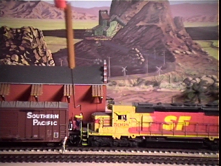

Actually skewers do work and some guys prefer them (particularly those who snip off the Kadee pin), so having some for visiting operators might be appreciated.
Do you have velcro around your fascia – for attaching throttles, clipboards, etc? Some guys wrap the velcro around pencils and skewers so they too can be scattered around the entire layout. Keeps 'em off the surface of the layout.

I know some modelers who clip off their trip pins entirely. When they want to uncouple, they put the point of a skewer (or pencil) between the knuckles of the couplers and twirl. Each knuckle is pushed in the opposite direction, and voila. Doesn’t work so well on passenger cars with diaphragms, though.
