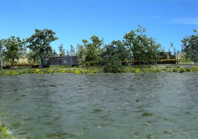

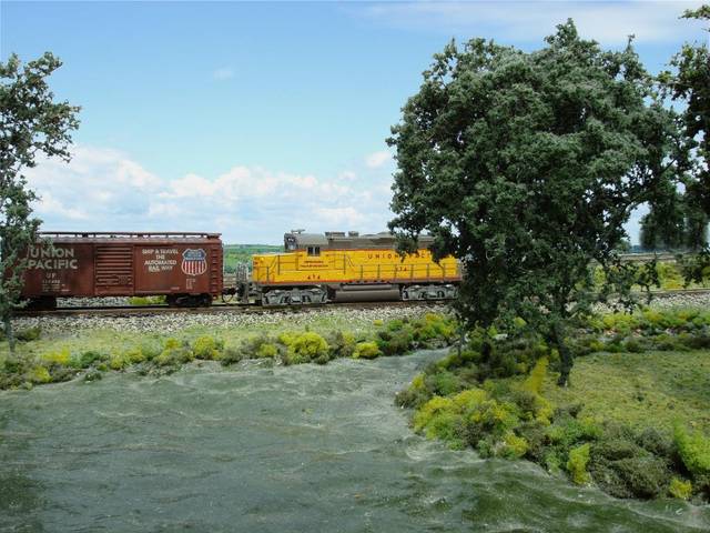

I have used a product called Klock-Kote. It is a two part epoxy that sets up in about 24 hours. I like that you can make changes within the first hour or so without any damage to the project. Here’s a couple of pics. Good luck, Dave
Click for a better veiw
It works good for creeks as well…

How did you get the waves? I use the same thing for water but mine dries flat.
