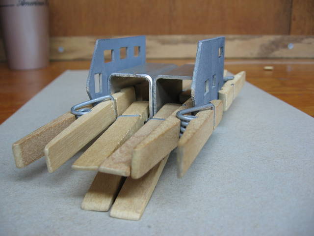

To hold a 90deg angle on the walls it is good to use clamps but you needn’t rush out and buy expensive fixtures right away.Here is an N scale building fixtured with scrap aluminum tube and clothesline clips. It helps to work in a race car shop with lots of scrap, but HD or other hardware stores frequently have thin wall square tube or perhaps you have some other source such as broken lawn furniture and a hacksaw. Anyway here’s what the fixture looks like in use.
Hope that helps. J.R.
