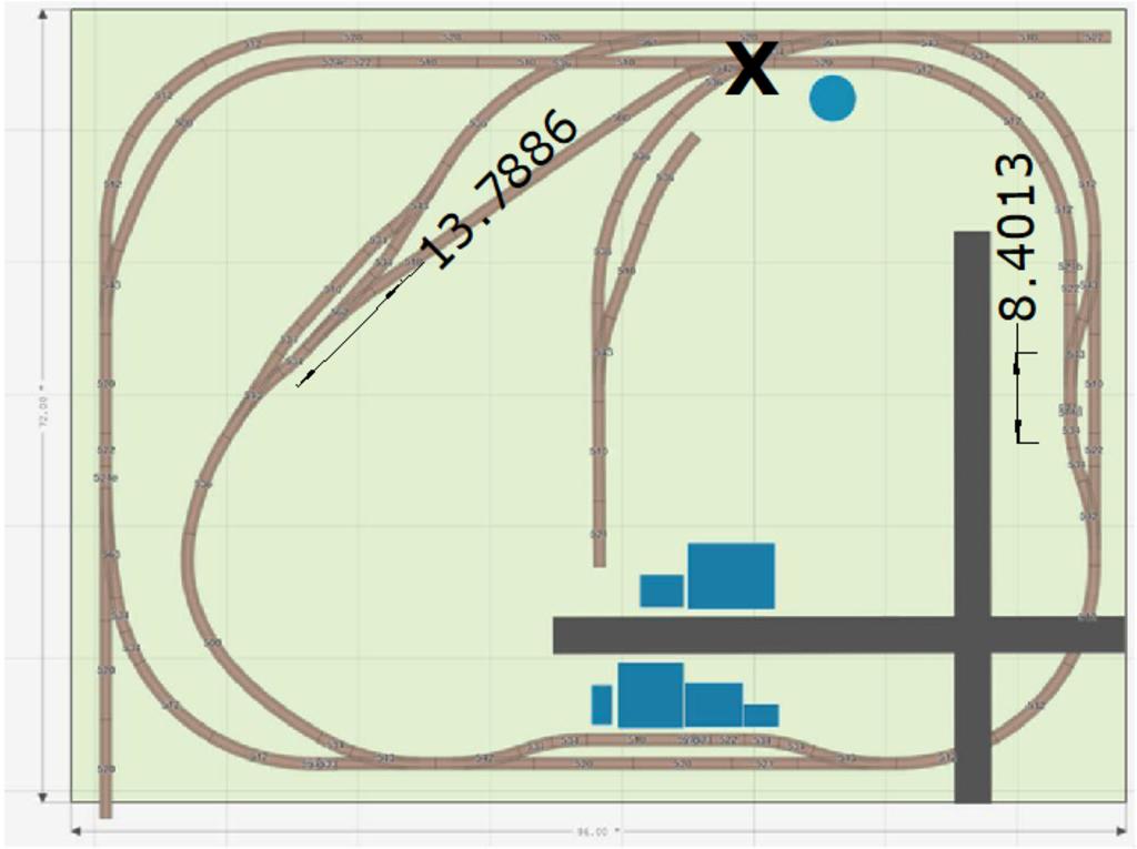

Looking for feedback on track plan
Working on my first ever layout and I’m looking for feedback on the track plan. I’m looking for basic operational interest, but more so interested in scenery. Let me know what you think.

Assuming each block represents 1 foot, reaching into the center of the layout is going to be difficult.
Personally I would prefer more switching opportunities, but some people prefer to watch their trains run. The stub sidings on the lower left and upper right don’t have a lot of room for an adjacent industry.
I agree with Heney, reaching more than 30 inches, unless you are 6’8 or taller will be difficult. Use also need at least thirty inches on each side for a person to get by, and 36 is better.

8’ x 6’, can you reach everything? For laying track, doing scenery and running trains? and to be able to get at any problems that need fixing?
I guess my thoughts are, I’ve done the island style, if given the chance, the next time will be around the room.

Just a couple of questions.
The short sidings would be a waste of space and turnouts for me. And if the X is all in the same level it looks like trouble with a capital T.

The other thing is, the diagonal just provides a shortcut to the route around the outside. What’s it there for? As in, what is the railroad explanation? Lower grade? If you leave all that off, you can put a small yard along the left side, and also make an area removable next to it for access/operating pit.

Lets hope that you have access around the entire layout, because a person generally cannot reach trackwork that is more than 30 inches away. As others have said, you wont be able to reach the middle spur regardless if you can walk around the layout. A better use of space would have scenery in the middle, maybe at a diagonal, or a simple viewblock/backdrop down the middle, cutting the layout into two separate scenes. Many people find that more desireable since it gives a sense of distance.
The double ended sidings are too short to be useful. Their purpose in operations is to allow one train to pass or run around a cut of cars. You only have length for one car, which you will find to be not very useful.
Here are some popular plans found on the internet that are about your same space. The first has an open pit, the second has a viewblock. Notice how they push the track more to the edges of the benchwork to provide reach, and notice how long the double ended sidings are.
This plan by a Forum member, Cuyama. You could add straight sections to increase the depth to 6 feet.
And here is a plan that uses buildings as sort of a view block, for more of an urban setting. Could be widened, but notice how the tracks are all kept within easy reach. The creators of this trackplan have many:

On my 1st layout, I had a duck-under. It was annoying crawling on the rug to reach the layout. The layout benefits greatly having folks get close to the entire operation.
Reach is another issue I had on the 1st layout. It was difficult using a stepladder to reach places. I spent time afterward picking up what my arm knocked over.
Both of these issues I avoided on my 2nd (and current) layout. Never regret having a point-to-point layout without a duck-under. Also, everything on the layout is 24" wide (the corners are about 30").

I too see many operational/practical problems with your initial thoughts.
The reach problem, in my opinion, will be your biggest problem, both in construction and operation.
Some questions:
  • How many levels is this track plan?
  • Are the track intersection in the upper part of your plan crossings or elevated crossings (bridges, viaducts, etc.)?
  • If the inner loop of the upper section is an elevated section the transitions will be harsh and a probable cause of derailment.
  • Left of the blue dot there seems to be a turnout and a crossing in the same space. (Pauli exclusion principle: Two (objects) cannot occupy the same space).
  • If you are planning on grades what are the percentages of said grades?
  • The black cross in the lower right, as drawn, shows the track passing under this feature. Did you mean to represent this as a level grade crossing?
  • What do the upper two sets of blue blocks represent? If these are meant to be rail-served industries the distance from the trackage to the buildings is quite a gap.
  • What is the purpose of the two spur tracks in the upper right and lower left?
  • Not having traced the electrical path of the diagonal in the center does this create a reversing section?

I like the over and under plan but your drawing is only understood once you blow it up.
You could keep the space but lengthen the problem (reach wize) by extending them. Run the one with the runaround nearer the left isle and the other loop down into the town at the bottom and move the screen more to the top. That would at least greatly reduce any turnouts out of reach leaving only a single track out of arms reach.
I had a 4X6 layout which was fine. When I got kicked out of that room by one of my boys, I moved to another room in the basement and opted for a around-the-room shelf layout, with a liftout. I never regretted that decision. You get more reach and more room for a mainline with such an arrangement. There is also more backdrop space for scenery. And the track plan can be super simple. Mine is a bit complicated, but it could be as simple as two parallel mainlines with a few sidings. If you stay within 18’', you can use metal supports screwed on your studs – really easy. The liftout is the most complicated part to build - but it’s actually not that hard if you follow some basic principles, the main one being that you need side braces at the receiving end to ensure that the liftout falls exactly where you want it, that is, to align with the track. If you use hinges above the liftout, elevate them by an inch using blocks. A power switch that shuts off the entire system when the liftout is “up” is also an important feature to prevent the trains from making the big leap if you forget to put the liftout back in place… There are threads on this forum that cover gates and liftouts very well. And duckunders are no fun when you need to carry things. They are also a back breaker and a knee bruiser!

If the section of track at the X is elevated the grades are pretty steep if they begin at the turnouts.

I didn’t do the math but a 6.25% and an almost 7% grade, on curves too, seem unrealistic.
Eliminating the “top” turnouts on the “S” curve on the right and moving the turnout on the right “down” to the other turnout will lessen the grade but I don’t know if it would be enough for reliable operation.
The more I study this plan the more questions I have about the entire elevated section and the track below it.

Ya know going back over the responses I think everyone was thinking HO, if he is planning N the grades will drop into the 3½% range. I’m hoping he is still delayed under moderation and that we didn’t scare him off.

I’m positive it’s HO. When you enlarge the plan, all of the track is Atlas, the 520 referes to Atlas code 83 9" straight track.
I didn’t see his plan in any of the track plan packages.
