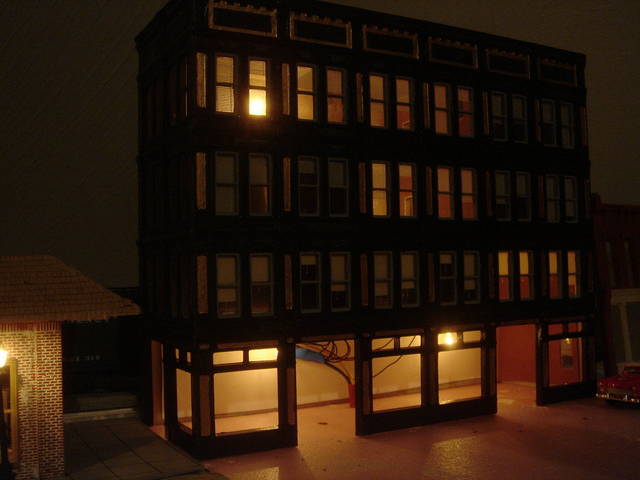

This is the rear-view of the M.T. Arms Hotel kit:
I used 3/16 foamboard to build up the floors and walls inside the building. Here, I put 6 bulbs in the building. I use Miniatronics 16-volt bulbs, but I run them at 12 volts. They should last a very long time, and they produce a warmer glow and a lot less heat, too. I wired the bulbs through holes in the foamboard, and secured the wires with Aileen’s Tacky Glue. Since the building is close to the front of the layout, I printed up floor and wall covers and added that detail.
I try to position the lights so that they can’t be seen directly through the windows. You can also see the Venetian blinds in the windows. I got a sheet of those from City Classics. From the front, it looks like this:
The interior wasn’t complete here, and sadly it still isn’t. But, I’ve put a lot of interior details into some of these buildings, and I think it’s very effective.
This building is on a narrow shelf part of the layout, which is against the wall. The back of the building faces the wall. In that situation, it’s a good idea to cover the back windows with a sheet of paper so that you won’t get window-shaped beams of light on your background.
It’s a small thing that no one will ever see, but the pictures on the wall of the hotel room are Dogs Playing Poker and a velvet Elvis.
