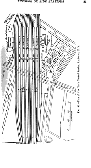

Found the book “Passenger Terminals and Trains” by John A. Droege - A true bible on every aspect of the “passenger train” -
Rochester NY station:
The station has 10 through passenger tracks and one express track. The former are arranged in pairs, 12 ft. on centers, and 28 ft. between adjoining pairs so that 19-ft. platforms are used. The Bush train shed is 1,100 ft. long at its longest part. Some of the platforms, however, are 1,400 ft. long.
The station platforms are reached by a subway on a 7 per cent. incline down from the station, 76 ft. wide at its entrance and 40 ft. wide and 8 ft. high under the tracks. There are two nights of stairs from the subway to each platform. Train indicators are placed at the foot of the stairways and since there are doors passengers may be held there until trains are ready.
The baggage and mail rooms are under the tracks. The express room is adjacent, being under the freight tracks or just north of the station. Baggage is trucked from the baggage room in the station on a ramp paralleling the passenger subway. It is taken to the platforms on elevators, each platform having an elevator at each end. Mail is handled in like fashion, but there are also two mail chutes in the north platform for carload lots. Express in small lots is handled similarly to baggage and mail but larger lots are loaded onto cars placed at the special express track to the south of the other ten. There are special express offices fronting on the street in the rear of the station.
The station’s coach yard
