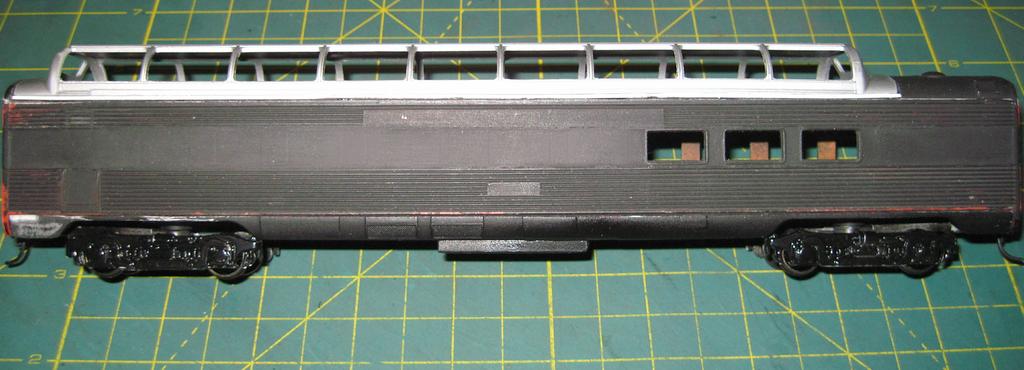

Doing a passenger car kitbash is really pretty easy. I wanted a Southern Pacific ¾ Dome car, because the SP built their own dome cars in the Sacramento Shop and only built 7 no one makes one in HO. I made my own SP dome cars from Athearn Diners.
Bachmann 85’ full dome windows fit the Athearn 72’ shell perfect for the ¾ dome length after some surgery.
I ended up making four SP ¾ Dome cars.
