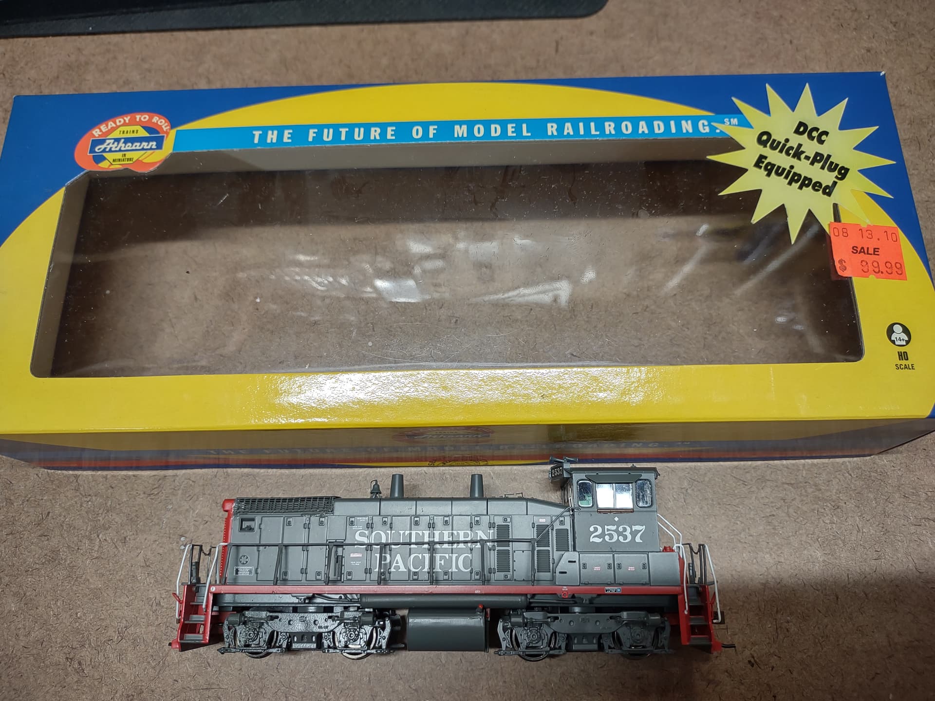

I have a Athern blue box switcher that is DCC ready. Im looking to add a decoder and possibly sound to it. It shows that it will accept either a 8 pin or 9 pin plug. Im fairly new to the DCC world, so if there is a solder free option that would be even better.

It is a SW 1500.

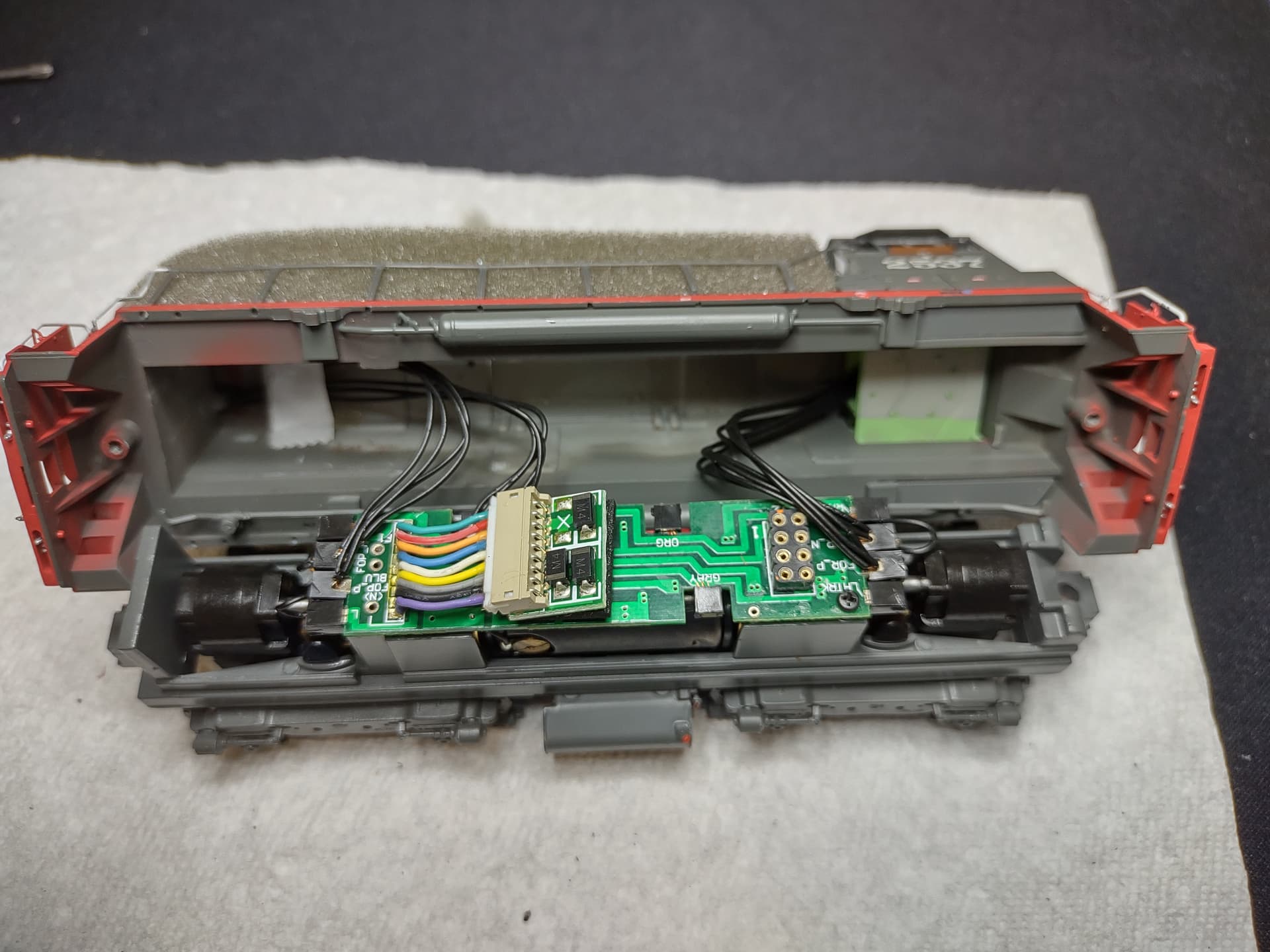

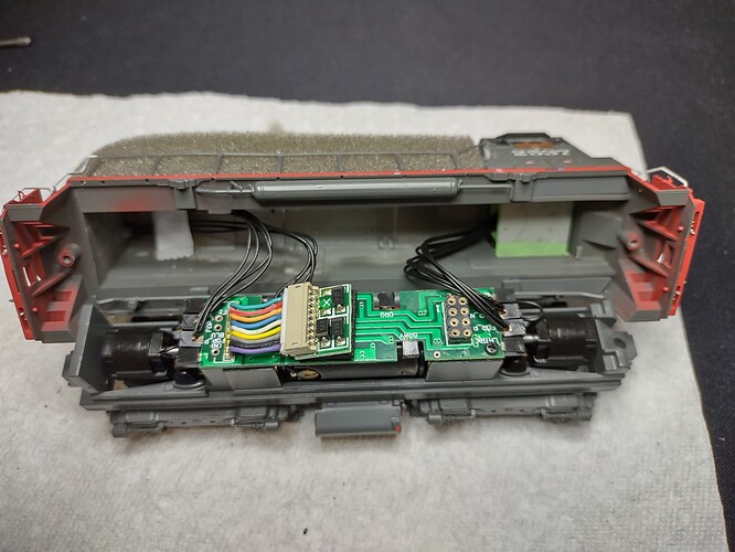

I have the same locomotive, but mine accepts a 21 pin decoder. On mine, you remove the top cover on the hood, pull off the dummy board, and plug in your decoder. Yours may or may not be the same, or similar. First thing to check is whether that top cover just slips off on yours. If so, it’s easy. You don’t even have to remove the shell from the chassis.

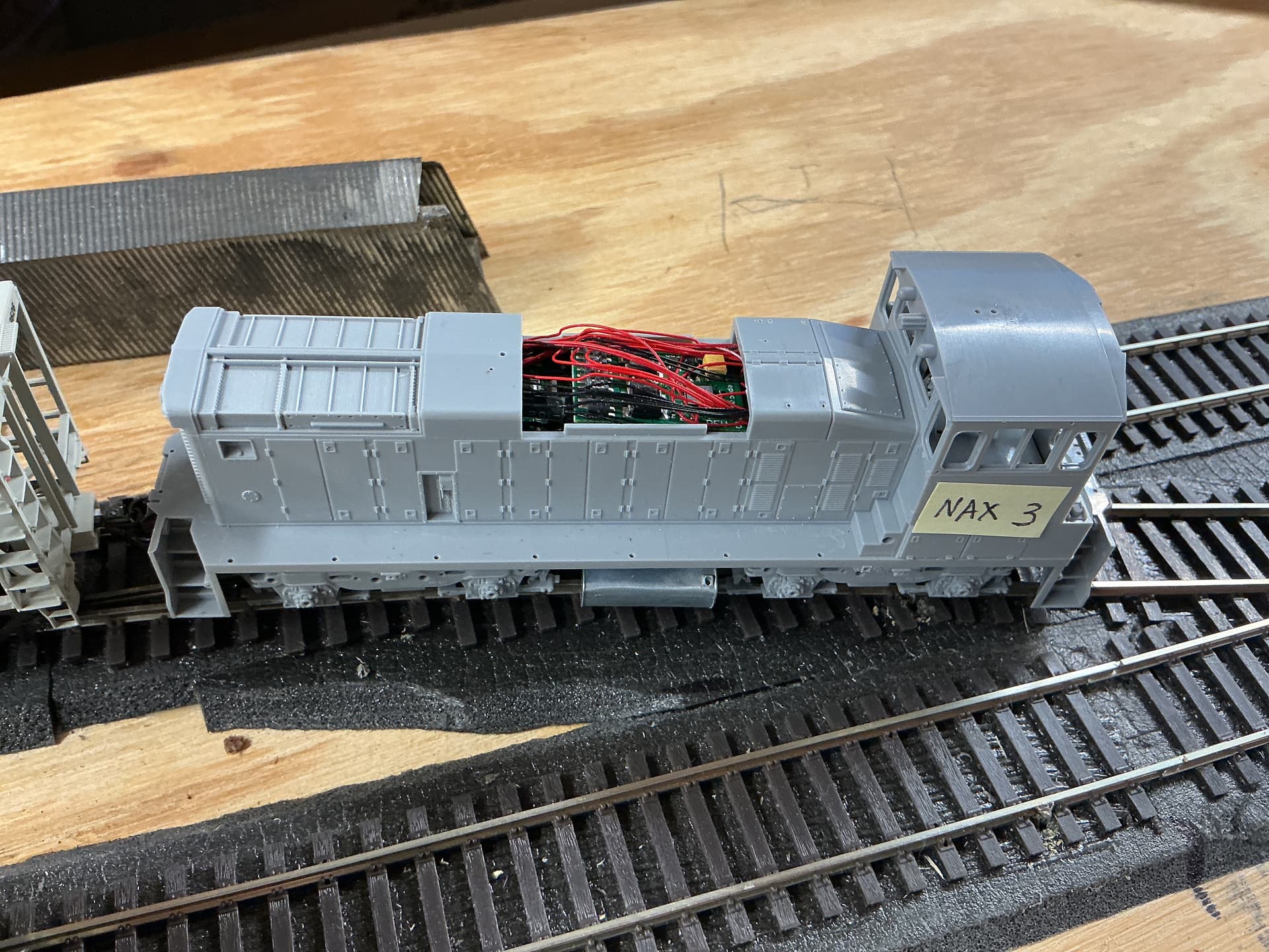

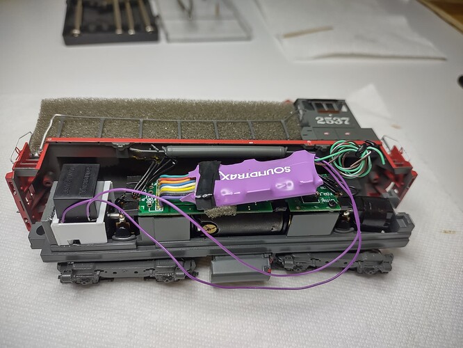

I ended up going with a TSU-2200 decoder and a sugar cube speaker.
Had to make a box over the front drive and trimmed down the baffle a little.
Works pretty well, have some fine tuning to do with decoder.
