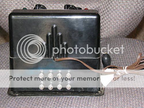

Well… Here are all the transformers I have (will have, I don’t have the Z yet)
Lionel 80watt, has an accesory hook up.
Lionel Type A,
Lionel type S. this is a screwy one. the only 0 up range is 0 to 14… so locos run scale speed with this one
The type A and the Type S have the same post arrangement…
Regular Lionel 40watt… no accesory posts on this one…
Lionel Type Z… I am using seperate direction and whistle controllerswith this one.
back…
And an older 45 set style transformer
Was I thorough enough?[8D]
Thanks for all the help…
If the CW-80’s date code begins with “G”, U is common. Otherwise, A and B (which are connected together internally) are common, but the whistle and bell functions are swapped.
For the A, if you use A as the common you get 14-24 volts from U. If you use B as the common, you get 6-16 from U.
For the S, if you use A as the common, you get 10-19 volts from U. If you use B as the common, you get 5-14 from U.
For the Z, U is common.
For the two-terminal 45-watt transformer, it doesn’t matter which terminal you use for common.
I don’t know about the Powermax.
Note that the transformers will not necessarily be in phase just because you connect the commons together. For that, you need to reverse the plugs as needed.
