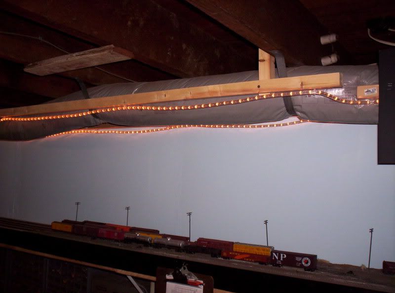

My lighting system is fairly simple: right now, it consists of two sets of rope lights. The lights are mounted on 2x2 lumber. The back row is mounted to the wall and the lights hung underneath, the front row is hung from the ceiling joists via short segments of 2x2 lumber, like this:
Note: Most of the layout doesn’t have a duct running above it, just the yard.

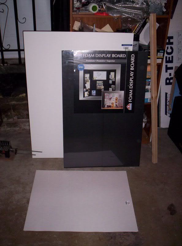

Black 1/4" foamcore boards
White 3/16" foamcore boards
White cardboard

The frame is first. Since I have an unfinished ceiling, I measured out a straight line along the front edge of the layout and screwed 12" lengths of 2x2 lumber every few feet from the ceiling, and attached 8’ lengths of 2x2 to the lower edges, measuring with a level to ensure that things were straight. Once the boards were in place I attached the mounting clips for the rope lights and plugged the lights in. By themselves, the rope lights don’t cast much of a glow, and their appearance is kind of distracting.

Very interesting project. I am planning to build a valance for my layout which is in the garage. Where do you get the black foamcore boards and how big do they come?
Doc
The boards I used came from an office supply store, they are intended for presentation displays and are a three-part board. The middle part is 24x36", the two “wings” on the ends are 12x36", I cut each one into four 12x36 boards. It’s also possible to buy the black foam at art supply stores in sheets as large as 4x8.
