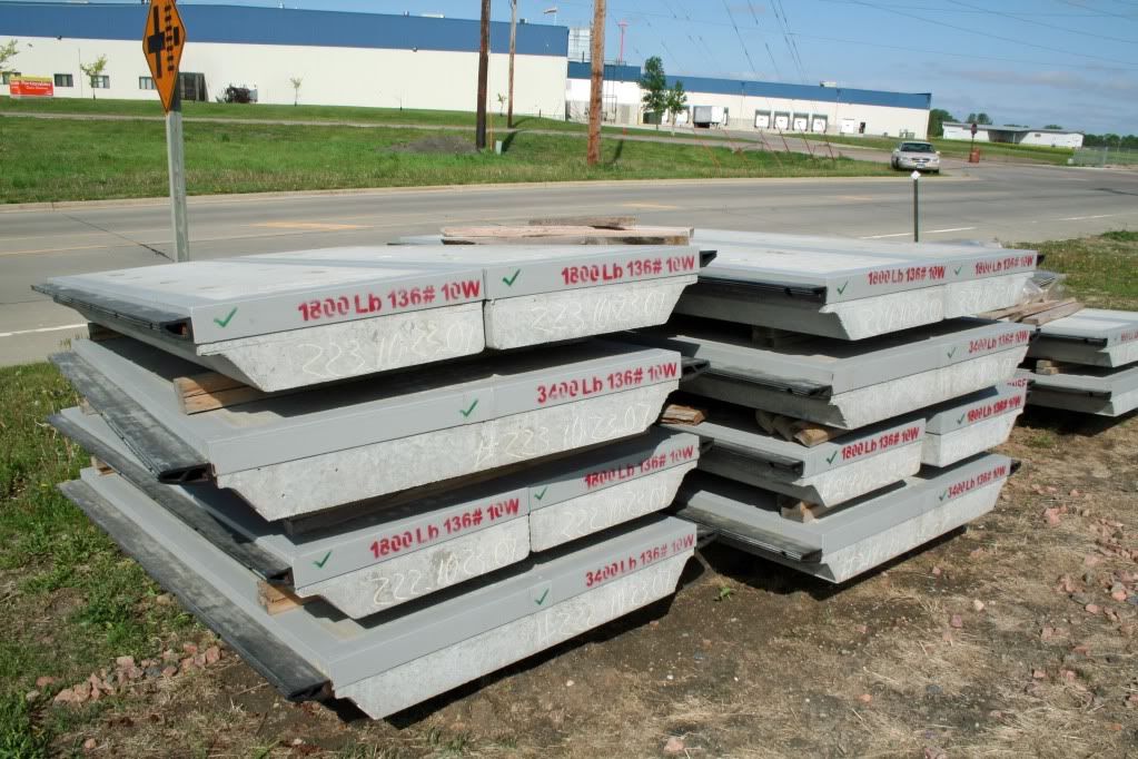

These are precast concrete panels used to surface a road crossing. They remain unused at the crossing 2 years after the project was conpleted.
Looks like about 4 panel-lengths in the photo - each about 5 or 6 feet long, so 20 to 24 feet or so altogether. Each such length consists of a center or “gage” side piece (“3400 Lb”), and 2 outside or “field” side pieces ("1800 Lb). Note how they’re stacked in panel-length groups, with 2 field side pieces on top of a gage piece. Also, note how the bottom corners are beveled to provide space for the tie plate and fasteners (spikes or Pandrol clips, etc.) - the gage pieces are the ones with 2 bevels, the field pieces have only 1. Note also the rubber sealing strips on the sides that will fit against the web of the rail, but under the rail head. Again, those on the gage pieces are wider for the flangeway than those on the field side pieces. Interestingly, they’re also stencilled for 136# rail, so it’s either a main track, or someone did the smart thing and upgraded the rail as much as possible (almost - could have used 141 RE instead) through the crossing.
They’re surplus or left-overs ? The project was completed with others like these, or were none of these used at all ?
Wonder who owns them ? If a government - township, county, or state - bought them specifically for this crossing project, then they may not know what else to do with them, and are leaving them here for spares in the event of damage, repairs, replacement, etc. Or, maybe they were just forgot ? [%-)]
  • Paul North.
The panels are the left overs, although there are not now as many as in the picture. The line is BNSF between Sioux City, Mitchell and Aberdeen, which was converted to 136# CWR (perhaps) 8 years ago. The crossing that was redone two years ago undoubtedly is newer than the rail line, and it is a city street. Crossing lights were installed for the first time at this location concurrent with the street work. Although BNSF equipment was present and (I assume) BNSF personnel worked on the project, I suspect the panels might belong to the City.
On the other side of the right of way there is one length, presumably a quarter mile long, of CWR.
