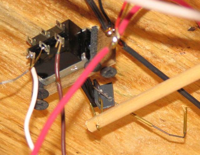

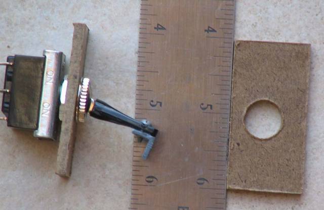

One of the easiest mounts I’ve used was designed by Jeff Otto. Its a rectangle of masonite with hole cut in the middle for the stem of a toggle switch to go through. Then you just use 4 1 5/8 or 2" drywall screws along side the piece of masonite to hold it in place and clamp it down.
Here is the bracket and one installed on a toggle:
Here is one installed under my layout, note that 4 drywall screws hold the bracket and toggle in and a 1/4 in dowell with a brass rod through it is being used as a pushrod:
Dave H.
