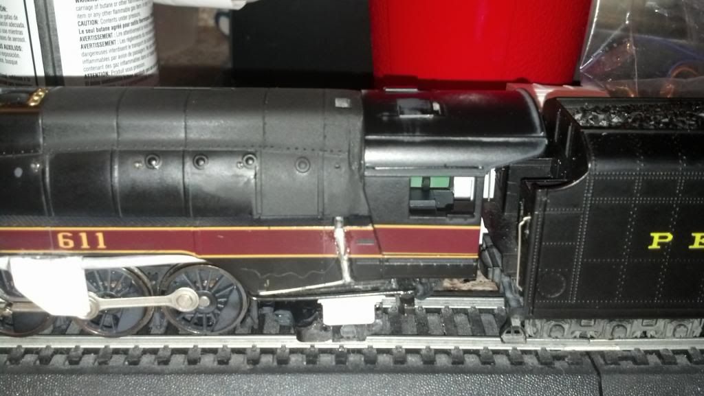

If it is anything like the MTH J class I am ripping apart to go from a 4-8-4 to a 4-8-2 N&W K2a, the decoder in the tender will be twords the rear, under the water portion of the tender shell with the speakers under the bunker. The decoder is really not that big, and you might be able to relocate that card to the coal bunker area. I would recomend to you to use a band saw with a metal blade if you can. Cutting my J apart to shorten it was not easy at all by hand since the metal is around 1/8th inch thick or so. You could also lengthen the firebox by cutting the boiler and frame, spreading them apart to make the 4 wheel trailing truck fit. Greenway Brass makes very nice, and resonably priced Brass trailing trucks if Bachman will not respond.

Yes I did cut her apart. It is a long story as to why I chose this one to cut apart.
Before-
I have always wanted a K2a, but the only ones I can find are brass. I cut the boiler, frame and skirts down a 1/2 inch (roughly). I also moved the motor forward as well, since the motor would have to be in the cab after I was done. I also installed a more accurate freight tender with dog house. The K2a I am doing is 126. I also moved steam domes, pop off valves, whistle… Here is where it stands now. I just have not painted the tender yet.
and here is the split area-

Wow, I´m impressed by your job! Your K2a looks good! I didn´t know about the different tenders the K2a´s had. Always thought their tenders where identical to the J´s. By the way: how did you manage to remove the decoder and sound speakers from the MTH tender and put it in that Rivarossi/AHM tender that you wanna use for your K2a? Was it complicated or rather easy? Were the decoder and sound speakers screwed to the tender floor or glued to it?

Thank you! The tender floor is still MTH, I just mounted a AHM Y6 tender shell that I had laying around to it since the K2a used a tender similar to that of the A class (a 22 series tender with comonwealth trucks). The big difference is the 22 series tender on the K2 was rivited, while the J had an all welded, smooth tender. The speakers are screwed in to the floor, and the decoder was sitting in a small tray, held in by clips. Since the electronics are fried in this locomotive, I will put a Tsunami card in and re-use the MTH speakers.
