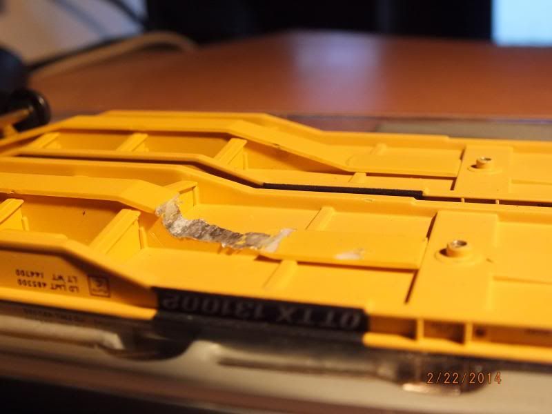

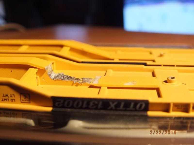

making a 81 foot long flat car turn sharper.
hey guys. i decided to take the plunge and take my dremel to the bottom of one of my walthers flatcars. and make the axle turn more by removng some of the center beam where the inner axle wheels hit it and limiting its turning radius, which is 24"in.
i will go back and get a different bit to clean the area up and give it some paint.
the reason for this was i decide to run my flats and found my yard lead radii where to tight. so i ripped up the section and im in the process of redoing. so got me thinking between my two staging yards in my pennisula, has a 180 degree turn, with a 20"r. and they would not pass thru there.
was thinking of ripping it up and pushing the edge of the track to the edge of the layout. may have been able to get it to a 22"r.
now the flats can make it around the 20"r which is the smallest radii so far.
hope this helps someone out
later
g
