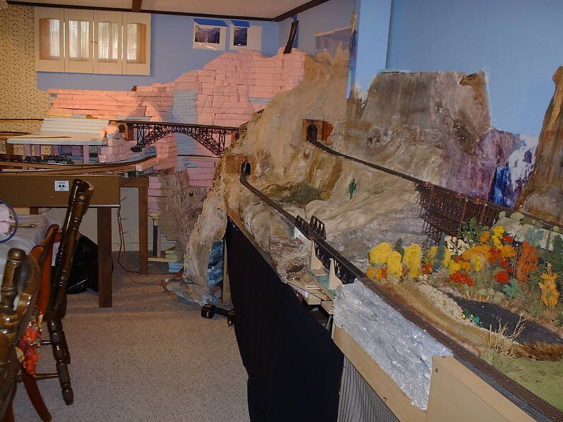

When I started the Sublime and Redikulus I had three scenes to build around. At each end I wanted a mountain, one in Minnesota with a lumber camp and the other in Arizona with a gold mine. I wanted them connected with a high bridge and a curved trestle across a floor to ceiling canyon modeled after Yellowstone. I am about done and here is a pictorial record.
A long shot with only the high bridge
The first task was to build a solid base for the canyon that could be stood on during construction. I use old oak stair treads
Then I started to stack the foam
Many sections were build on the work bench
I started to learn how to carve Hoodoos
Some paint and the Yosemite falls was added
The trestle is built and installed and the river is begun
I added some backdrop
The last wall section of foam is started
