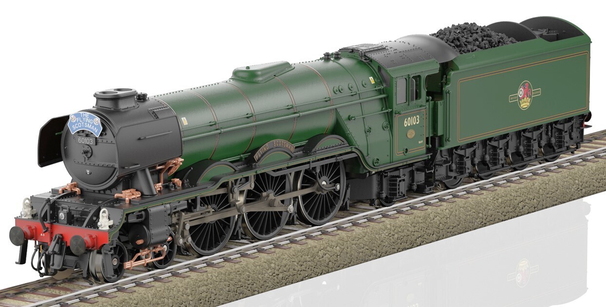

Märklin/Trix Flying Scotsman really HO scale?
I can’t believe it because they don’t clearly indicate that it’s not OO gauge.
Trix official site
www.trix.de site says “In 2023, the “Flying Scotsman” celebrates its 100th anniversary and will adorn the H0 assortment of Märklin and Trix.”
You’re confusing Britain and the Continent. HO was invented in Germany (Marklin), 3.5mm to the foot, which is one half of European O scale (7mm = 1 foot, or 1.43.55 scale). It is the scale used in Germany, Austria, France and most other countries in continental Europe and Scandinavia.
However, when HO started, the smallest available motors wouldn’t fit in the smaller British steam engines, so they went with HO gauge track but used 4mm to the foot as the linear scale. OO scale.
So yes, Marklin and Trix and the other German companies are making HO stuff, not OO. Although they primarily do German prototypes, they do sometimes do models of other countries.
p.s. you can kinda tell by watching the model video that it’s HO; an OO model would be about 1/8th bigger and would hang over the track and not be in proportion to the HO Orient Express cars it’s pulling.

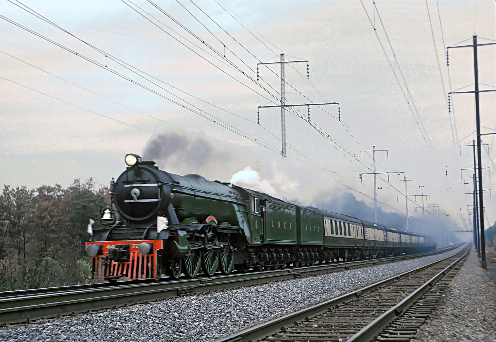

Scotsman_Glendale-MD-1969a by Edmund, on Flickr
I waited three hours, with my bicycle, trackside along the Nickel Plate and saw it come through Cleveland, Ohio back in 1969.
Regards, Ed
Technically PC wire, but the magic was still all PRR.
Would that we could see this scene repeated with 5550!
That’s a great photo. The US tour was from 1969 to 1973, so it must have run on the Burlington Northern line. I want this locomotive with the cowcatcher and a passenger train.

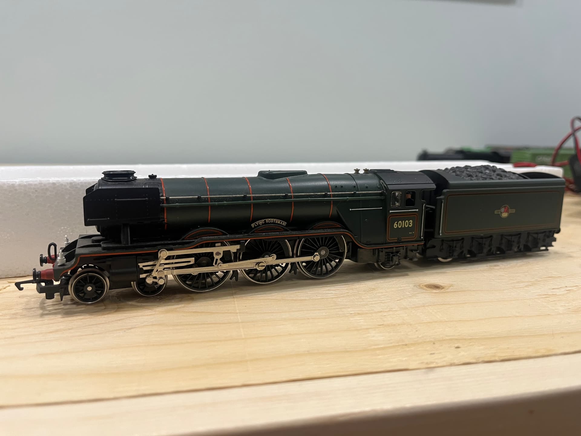

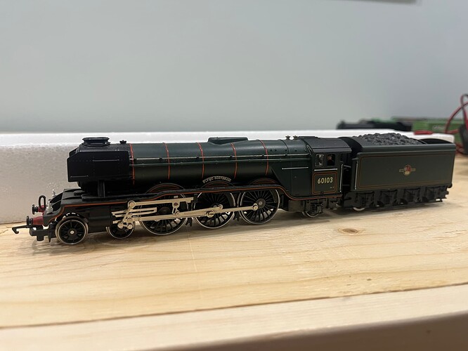

Probsbly a bit off topic from the original post but still Scottish. Back in the day my wife visiting England purchased this train engine for me.
It was made by Hornby it came with no documentation the seller apparently the best train shop in London according to someone in the know at the time as my wife said. He told her it was OO scale but would run on HO tracks. Was 75£ at the time I can say it goes ok but is a bit sketchy in the smoothness department. As I investigated it to find out the loco was just used as the electrical pickup on one rail and all the work is done by the tender pushing.
