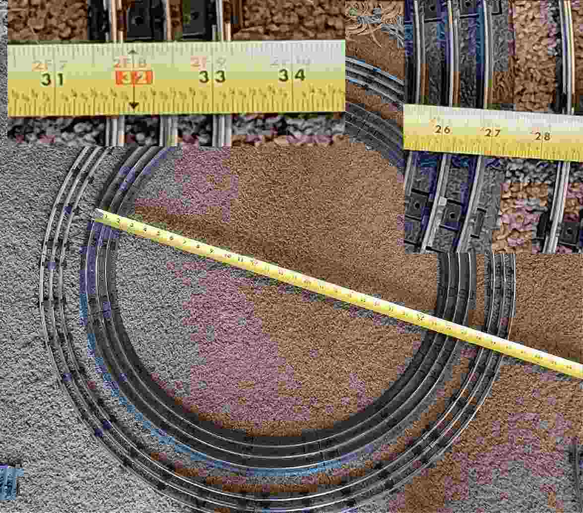

After my original posting asking about Marx O gauge track on a black roadbed. I went down a lot of rabbit holes on Facebook and other places. I did find some track and found out a lot more about it, As it was only made and sold between 1960 and 1961. After a lot of cleaning, the original engine and cars made a few runs around a basic oval. I still have a lot of issues to fix, which came to light after the run. Below is what I found out about the track and is a brief wrap up of the subject?
(I am now calling it Marx O27 and Mark O34 track)
  1. Marx track is different from the usual O-27 and O-34 diagram everyone knows.
    The dimensions - Marx track on plastic roadbed O-27: rail height 3/8", straight pieces 8-7/8" long, curves form a 26-7/8" circle, 3 rail ties per section, Listed as O27 in Marx instructions.
    Marx track without roadbed O-34: Rail 3/8", straight 11-1/8" , Curves form a 33-1/4" circle, 5 ties per section, listed in instructions as O34.
    If I intend to replace any track on the roadbed, it must be Marx O27. Why? Because the spacing of the ties in the roadbed I do have only allows for the three ties per section. So any track replacement on the roadbed, must be O27.

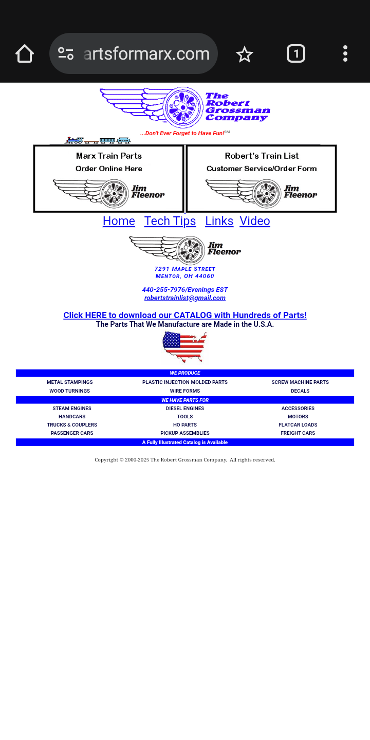

Oh boy–look what I found at Robert Grossman!
Look at X30!
Engine 1988, I don’t usually comment on things like this, but I feel it fair to caution you about this retailer. They were on my parts supplier list, but I received word from several readers that they had placed an order but never gotten anything. I sent an email query close to a month ago, asking about the company status, no response. I’ve since remove them from my parts article list.

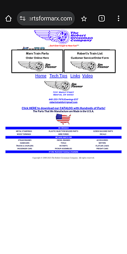

The first one, “parts for marx”, is the Robert Grossman company, who as far as I know are a legitimate operation. I have not personally bought from them yet, so I cannot vouch, but I know others have used Grossman as a source for Marx parts.
The second, “parts4marx”, I have never heard of, and know nothing about.
-El

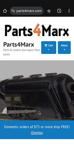

Here’s what the Parts4Marx site had to say.
Now that is something that I didn’t know of, but that explains why the Robert Grossman company has been ignoring customers and why there is now a second site.
I ordered from Grossman earlier this year (as I had done several times in the past). It did take a little longer to get my order than I had hoped, but part of that was my fault because I had to get verification that I had the right parts, so there was a conversation delaying the process. I do know that their selection of parts is wonderfully comprehensive.
And that was from the original “Parts for Marx” site?
My bookmark is to Grossman.
“for” or “4”?
“for”
The mystery deepens…
And that’s what makes collecting so much fun :blush:
