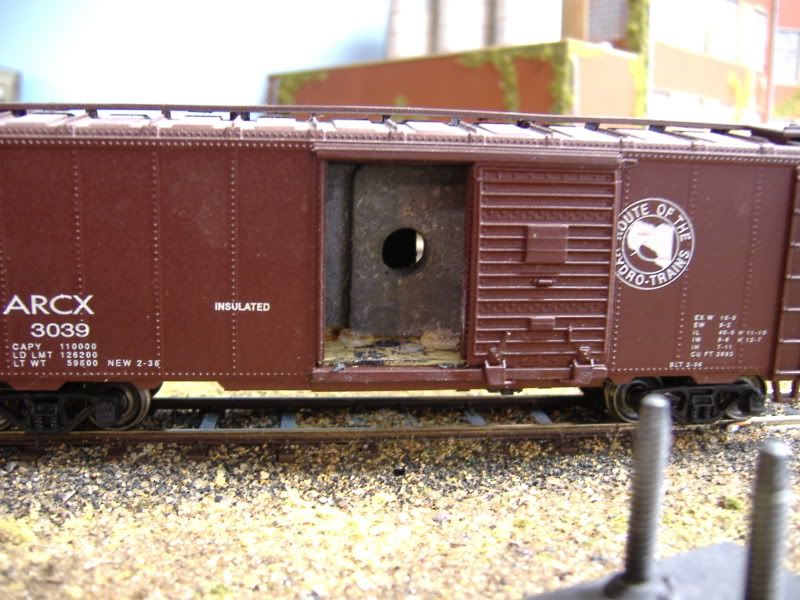

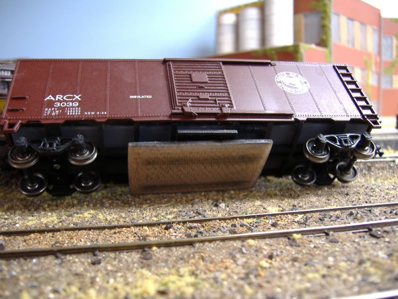

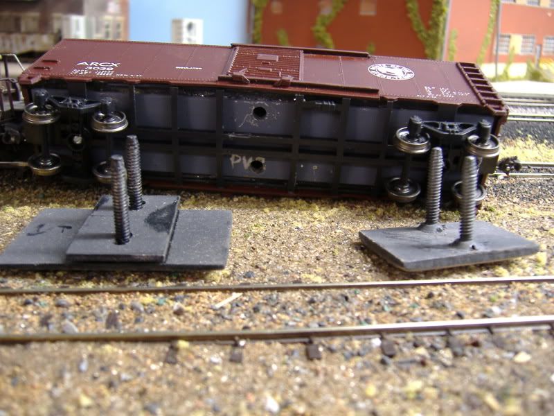

Here is a couple of pictures of one of my cars set up for it. I have two of them that I pull around. I paint the top of the masonite flat black and in the shadow of the car you don’t even notice it. This car I actually have two different pads made up. One of them has a weight on top of it. I use this one if I havn’t ran the layout in a while or it seems like the track is getting extremely dirty for some reason. When the pads get dirty just take a little sand paper and sand it down a little.
This car only I also add weight to the inside.

Thanks for the nice pics QuadK,
I have a question for you: How much weight do you put inside the boxcar and on the 2nd pad?
Thanks
Serge
wow ,I was going give a go at making one of these today ,and blamo heres all the info…this site is good !
The weight inside the car is out of an old atlas engine so it’s quite heavy. The weight on the pad is maybe an ounce or two, just for a little added weight.

John Allen’s track slider cars were weighted normally like his other cars, and the sliders themselves had no extra weight or springs. All it takes is the weight of the slider itself to keep the pad in contact with the track. Other than that, the most important requirement is that the vertical guides (nails, screws, or whatever) have to slide freely in the holes in the bottom of the car.
John ran several slider cars on his layout, and at the beginning of each operating session we helped him clean them by lifting the cars off the track and rubbing the sliders on sandpaper until the black streaks were gone. The track slider cars moved around the layout normally in trains, and when figuring “tonnage” for assigning engines we counted the slider cars a two each to allow for the extra drag.

No this idea doesn’t get any better if you make it more complicated, I agree. With that being said…I guess one thing that I had forgot to mention and probably should have is that my track is not level at all. I cut my rail every scale 39’ and twist and bend it to give it that rolling motion like you see on less maintained, branch lines or non welded rail. I had a problem keeping the track cleaning car on the track even with the pad moving freely up and down. The extra drag I’m assuming kept derailing the car. So that is why I added the extra weight to the car. Since I’ve done this I have not had any problems with the car derailing. This is also the same reason I added the little extra weight to the pad is to try and keep it a little flatter on the track. I don’t usually use this weighted pad on normal running, just when it seems the track seems to be getting a little dirtier than usual.
For a side note though…I have found that this type of track cleaning car does work better on 40’ cars than on the larger ones. I do have one on a 50’ car and for the most part works good especially with larger radius curves. Every once in a while though it will get snagged on the smaller radius curves that I have which are under about 20". Just my thought’s!
