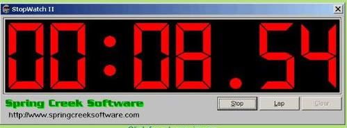

For those of you with no other handy clock, here is a link to a nice free one…which will run in hundredths for accuracy. Download the free one, not the shareware one.
http://www.springcreeksoftware.com/
This gets you to the main site, click the button in the left for “free stuff”. There is a large and small format clock to download…no expiry or license.
The large one looks like this when you run it ( I have the computer handy to the layout for using D. Pro).
The small one has no ad on it.
