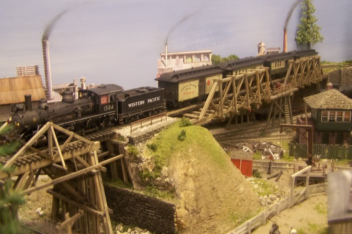

Just wanted to share some pics of these 34’ Overton passenger cars I own. Although not part of my railroad’s official roster, they do hold a special place in my collection. BTW, These cars are ideal for smaller layouts having 18R or sharper curves.
Bob, as usual awsome work. I love those little stubby cars. I am going to add some to my layout. Thank you for sharing you work with all of us.
Dave
