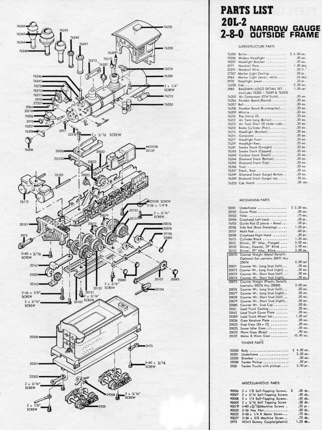

Also, I took the boiler off the frame to see how the motor is mounted. The motor is a Japanese open frame with the brushes mounted at noon and 6. The upper brush seems to be insulated from the motor frame, but the lower brush is grounded to the motor frame which is then further grounded to the locomotive frame through the motor attachment screw. Obviously the motor needs to be isolated from the frame. I’m curious as to what motor mounting method would be recommended, as I’m not necessarily willing to rely on a “goop” attachment instead of something that would allow motor removal if required.

Thanks, but I don’t think I have what you are describing. What I have looks something like this: http://www.hoseeker.org/assemblyexplosionMdc/Assembly%20Explosion%2020L-2%202-8-0%20Narrow%20Gauge%20Onside%20Frame.jpg. There is no connection from the lower brush to the locomotive frame. I believe that the brush is electrically connected to the motor frame, and the motor frame connects to the engine frame with one screw to complete the circuit. Also, your posted picture seems to show that the motor is supported in a plastic cradle, which would make isolating the motor frame from the engine frame easy. The model I have does not have this cradle, so unless the motor in the photo is shorter (less tall) than the original to compensate for the cradle thickness, that assembly won’t fit.

The plastic housing fits into the spot where the open frame motor fits. According to the link you included, look at how the motor fits in your loco. I do know some locos have one brush internally connected to the motor frame. That would requite isolating the frame of the motor.

MDC upgraded the loco motors before being sold to Athearn is what you see in my attached photo and they kept the same basic frame but went to the plastic motor housing and a better motor.
