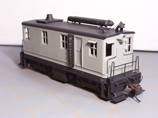

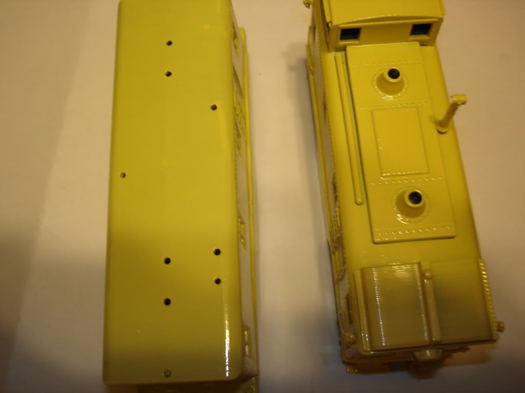

I’ve done two box cabs to the 44 tonner chassis after seening geared steam’s posting. Here’s a couple of pictures of them. The paint’s still wet and will get some toning down later. When you cut down the 44 tonner all I used was the frame and left the front and rear grills (cut down) in place and the box cab just slides over them. This leaves about a 1/4 inch in the front and rear that needs to be filled in. On the center door I used the original coupler and bracket on the second I filled it in with putty. Right now still working on the paint getting it to look right.
This shows the top of both. The one on the right I bought off Ron the other day on the bay site.
Side view of box cab/caboose.
This is the first one I did a couple of weeks ago. It has the center door and I used the original front end and couple from the kit.

Yup, I did one awhile ago too. This was a badly damaged MDC shell, hence the patchwork on the front. Fits nicely over the Spectrum frame and for $40 it already has a decoder installed. This is actually over the 70 tonner frame.
