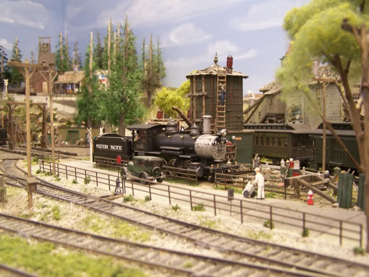

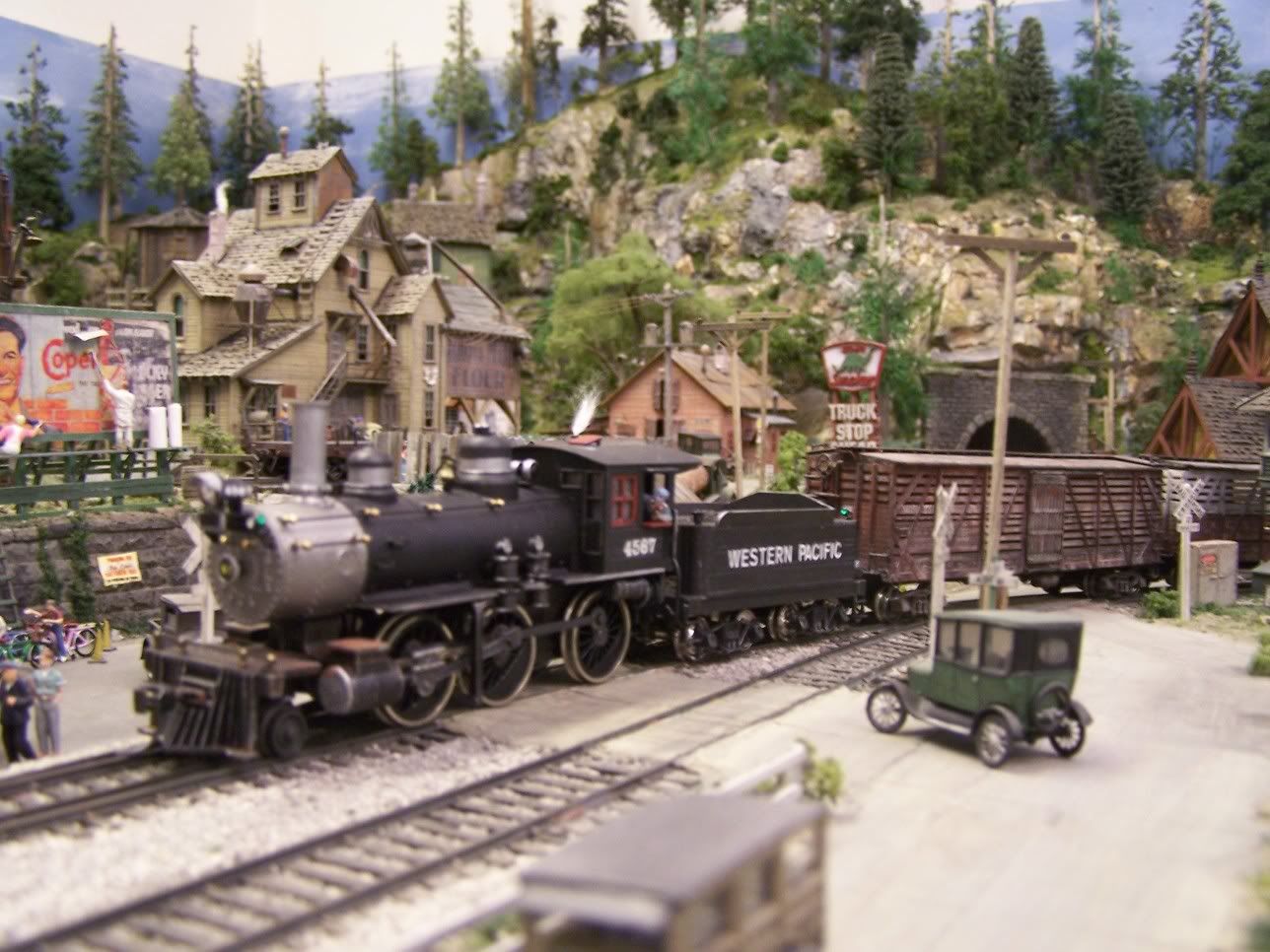

Here are some pics of MDC locomotives in my roster:
Bob, awsome modeling. I’m completely blown away. What year is it on your layout? I only hope that my layout will one day look that good. Unfortunitly, due to Parkinsons, assemblying kits is out of the question for me, I am going to have to hire someone to help me out. Thank you for sharing the pictures.
