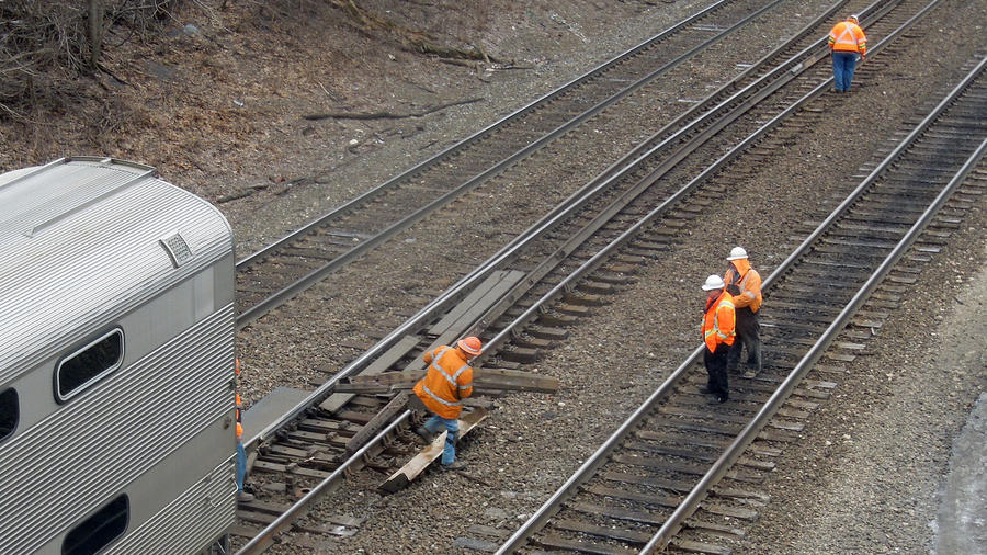

BNSF Metra train #1206 derailed this morning shortly after 5am at the East Naperville Interlocker on the BNSF Chicago Sub (East End). #1206 originated at Hill Yard in Aurora and was proceeding on main track #2 with equipment and crew only to its first stop Fairview Avenue at 5:39am. Only the cab car derailed and it remained upright. No injuries were reported. The main 1-2 switch sustained heavy damage on main #2. Here’s a link to a picture of the switch damage:
https://pbs.twimg.com/media/CauVzyGW0AAXCYI.jpg:large
BNSF Metra inbound trains were delayed for up to sixty minutes and outbound trains only operated as far as Lisle during the morning rush.
The derailed cab car from #1206 was rerailed @9:30. #1206 was released from the scene at 10:50 and sent to Chicago with a 25mph speed restriction. Main tracks #1 (north main) and #2 remained closed for most of the day from E Eola to Lisle due to cleanup and track repair at the E. Naperville plant. Main #3 remained open with a 10mph speed restriction by the E Naperville plant for most of the day. Main #1 was reopened at 4:15 with a 25mph speed restriction. Main #2 was still out of service as of 5pm. Minor delays were expected for the evening rush.
