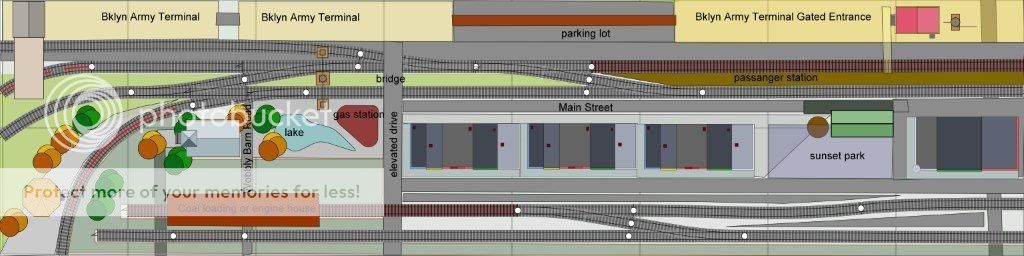

[:|]Yes, it’s the LH code 70’s that are nowhere to be found…I’ve got plenty to keep me busy till they get back in circulation…however, laying the track is at least in my experience…which is limited…about the first thing that gets done… So within the next few weeks if they don’t appear either I’ll have to go with Shinohara or Peco I guess . I’m really trying to stick with the ME code 70.
Only need 3 of the LH’s. I’m cramming a lot in to 2’ x 8’ ft…half of Brooklyn and some Pocono Mountains! [:|] with any luck it will be phase I and will add phase II on the next 2x8 leg to the southwest corner of the plan. There is no similarity to reality in my track plan…I don’t care at this point. Only have small space and this will give me a lot of detail and cool looking scenes…I hope…so I’m going for it.

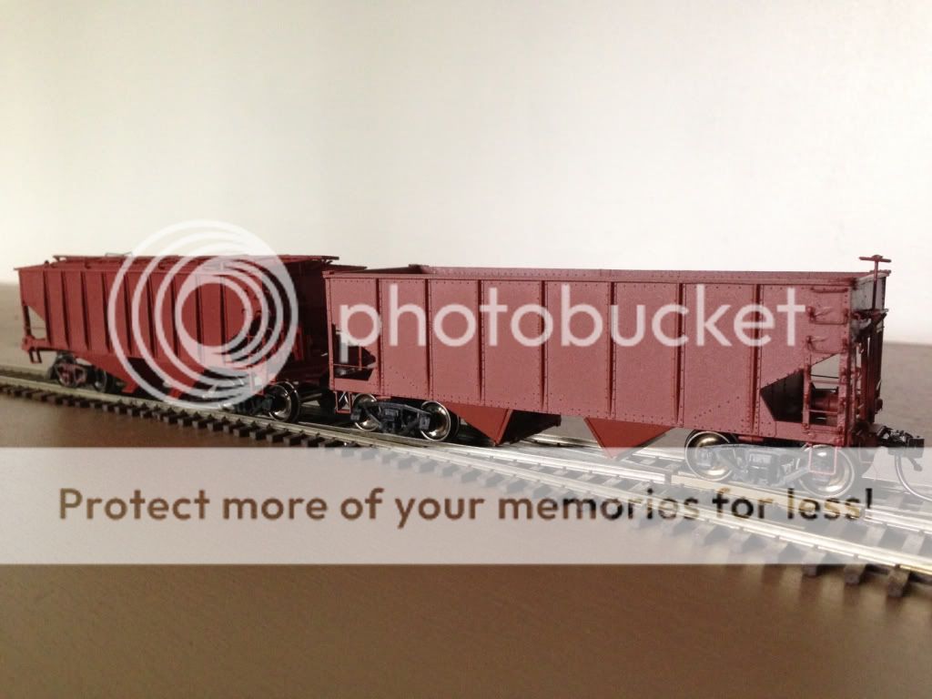

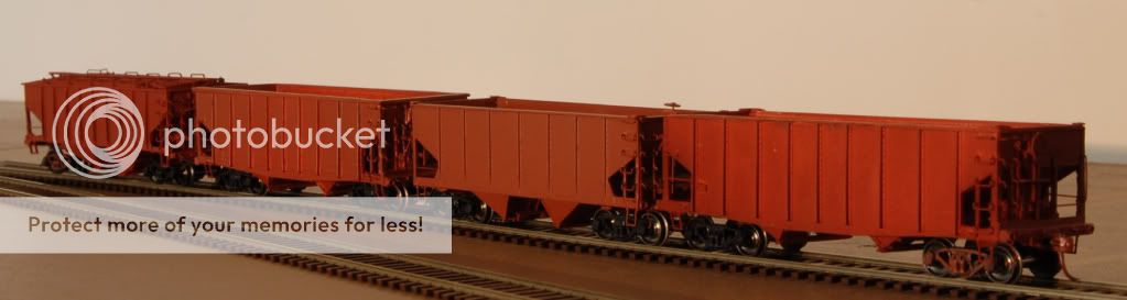

I’ve got 3 diesels that need lights, weathering and such, 4 old Walthers structures I’m going to clean up and repaint and light, building a sort of scratch built elevated passenger station, NY Transit style, 4 prr hoppers to decal and weather…so I could be busy for several months without those dang turnouts…but would love to run some trains one of these days.

p.s.: keep the soldering gun away from those hoppers.

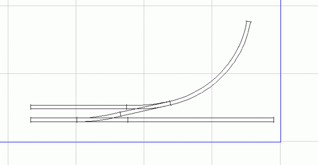

Flipping one turnout at the left will eliminate a potentially troublesome s-curve through the diverging route and allow you to use a right-hand turnout. Like this image (though it’s rotated 180 degrees from your orientation):
The hoppers will sit safely in the barn until all day labor punches out.
However there have been a few moments during construction of the hoppers when I considered using a much larger and heavier object then a soldering iron on them.

Hi- thanks for pointing that out. Much appreciated. Glad I posted that pic and glad you looked. I’ve got a lot to learn.
