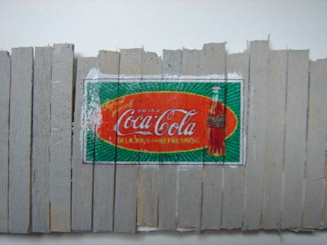

Get some decal paper and print your own. Get the right paper for your printer (inkjet or laser) and create your own page of decals. You’ll need a decal sealer, at least for inkjet, to keep the ink on the paper. Once you’ve done a few of them, they get very easy.
You can do simple lettering, and apply it to a smooth surface for a fresh-from-the-shop look:
Or you can import images from the web and apply the decals to weathered wood for a sign that’s been out in the weather for a while:
