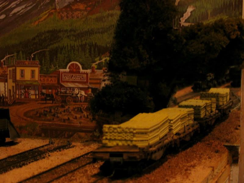

Here is an example of the use of a small mirror. The tree branches hide the edges of a small mirror used to extend the mainline into the wall. You see 4 flat cars, rather than only the two real ones.

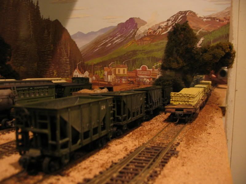

Here you can see the camera in the mirror to reveal the illusion.

One, where di you get the G&D coach in the second pic?
