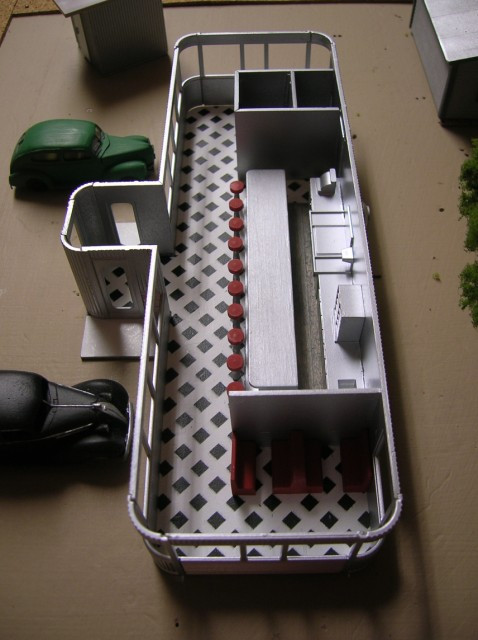

Like Frank, I also used Tamiya but used their Bare-Metal Silver (AS-12) and spray-painted it using one of their aerosol cans:
The paint goes on in thin layers (due to their superior nozzle) and highlights the exterior details quite nicely. The kitchen and counters were done in the same color and the linoleum floor has been spray-painted in a checkerboard fashion. I added individual wood flooring strips behind the counters.
The original plan was for the black & white tiles to touch at the corners but I taped it incorrectly. As it turned out I like the look of this better because it would seem “too busy-looking” the other way.
I also chose to remove most of the booths from the interior (except for the one’s pictured at the bottom of the 2nd pic, sans tables) because they seem too close together and HO-scale figures would look pretty cramped. I also plan to ditch the thick plastic windows that came with the kit and will go with a thinner strip of mylar for the exterior windows.

ah thanks. ya i saw that diner picture and was going to ask want kinda paint you used but post was back in 2009. but i like that colour. also i’m guessing the back of the diner is same colour
Yes, both the interior and entire exterior (including back, roof, and storage building) are all spray-painted the same Bare-Metal Silver (AS-12). The roof is also flat and I was thinking that two-tone scale gravel might look good on top.
