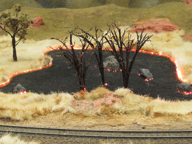

Seen an N-Scale layout today at the train show, they are modeling an active grass fire using fiber optics and the carousel was directly underneath. It really looked very good in person.
http://youtu.be/tCIc4NyPehU

Thank you guys! Geared Steam, thank you- though I’m not going to model an active fire, I took close looks at what they had done for the burned parts! I’ve seen the led’s used to model active house fires and the grass effect was pretty cool.
