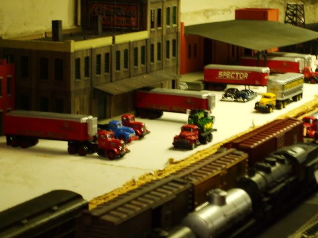

Ok after some whirlwind relocation here is what i have done so far, does it look ok, kinda weird having the buildings facing the wrong way, but i guess with some scenicing it will change things
the passenger car is going to be a future yard eating place with the public welcome of course

Rick, now that I’ve seen your real estate, here are a few observations based on your photos:
  • Your buildings denote a clear dividing line between zonings - commercial-industrial from the first semi away, then multi-unit residential-commercial, then single family residential. The road treatment for the alley along the edge of the right-of-way should reflect that: wide concrete where the 18-wheelers are (part of which would be city alley, the rest paved back yard of the commercial buildings,) narrower ‘patchwork quilt’ asphalt behind the residential buildings.
  • The residential buildings would have back yards, separated from the alley by high fences with gates. The gates would almost always have trash cans adjacent. The yards could be anything from garden club wonderland to unlicensed dump.
  • The commercial buildings would almost certainly have commercial-grade trash disposal facilities - dumpster-compactors attached to the buildings themselves.
  • As long as your scene is, it should be split by streets perpendicular to the tracks, probably at the zone dividing lines. The usual block length in an older part of town (which is what your buildings suggest) would be about 100 yards (subject to compression.)
  • The zoning authority would probably refuse a variance to the diner in its present location. Try to find it a home in the industrial-commercial district.
Some of the more entertaining TV here is live coverage of zoning discussions involving the Planning Commission, people who want variances and people who object. Getting a variance approved in the real world is only slightly less difficult than brushing the teeth of an unrestrained alligator. Granted that you are, simultaneously, Mayor, Council, zoning board, homeowner and developer, buildings of various types should be grouped, not mixed with wild abandon. With the exception of the proposed diner, you’ve done a good job of that.
