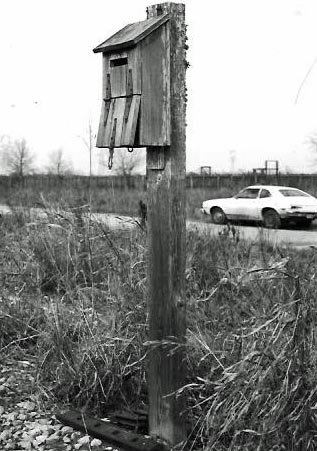

You asked for it- structures found at a railroad interchange. This is as close as I can find. It is not actually at an interchange between railroads, but at a junction of two “districts” of one railroad, the Santa Fe Matagorda District (Sealy to Matagorda, Texas) and the Hall District which served the Texas Gulf Sulphur Co. The “structure” is a box for waybills shown here in 1981.
Here is a general shot of the junction.
The box is on the left side of the picture beyond the switch stand. I think there may also have been a “blind siding sign,” a sign on a post to identify the “station” (ie. named location on the rr) where there is no station building.
