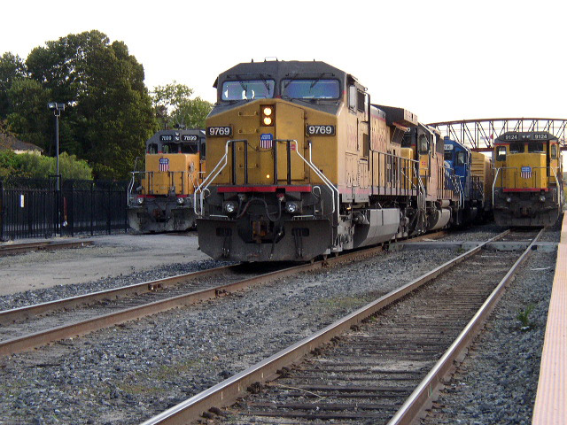

Most model railroad mainlines have track on a raised roadbed. However in some areas, especially urban areas, tracks are not only not raised above the ground but the ties are practically invisible - they are flush with the ground, all that can be seen is the rail protrucing from the ground…Such as this pic below (UP Coast Line main in San Luis Obispo, CA):
How does one model this kind of track and especially how does one sucessfully transition from raised roadbed track to this kind of track?
