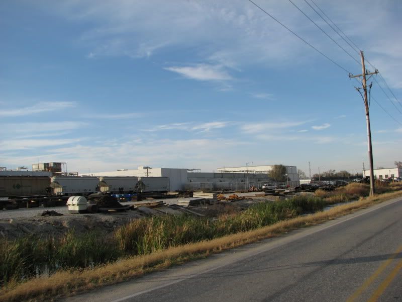

Here’s a line of reefers to be loaded with meat products at a packing plant in Fremont, NE

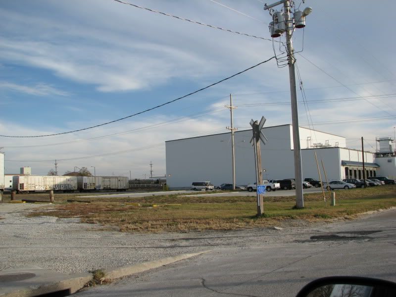

And the plant:
