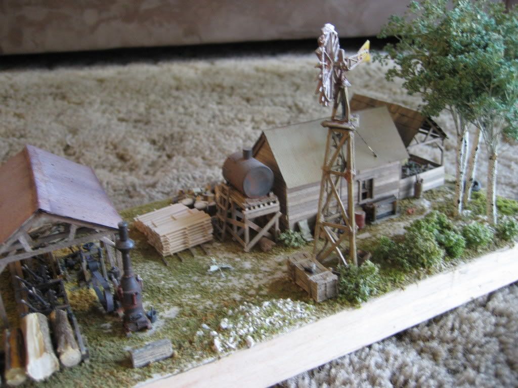

My dilemma is that this mini-diorama, of a non-rail-served sawmill, won’t fit in on my planned layout.
