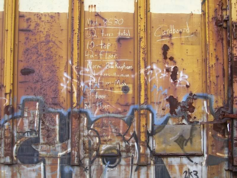

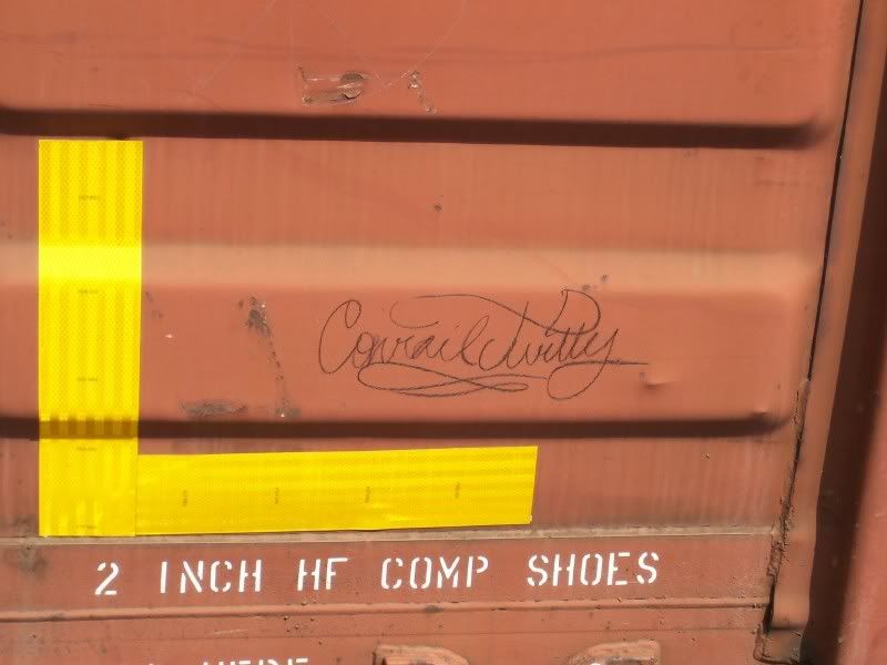

Here’s a few “chalked” graffiti shots I took at our local siding within the past month. The 1st is on on Columbus & Ohio River (Ohio Central) ex LEF&C Seico car & appears to be loading info:
The 2nd was on an NS waffle side boxcar & the 3rd of these I’ve found in the past couple years-“Conrail Twitty.”
Anyways, in this day of full side tagging, etc, the old style chalking is still alive & well.
