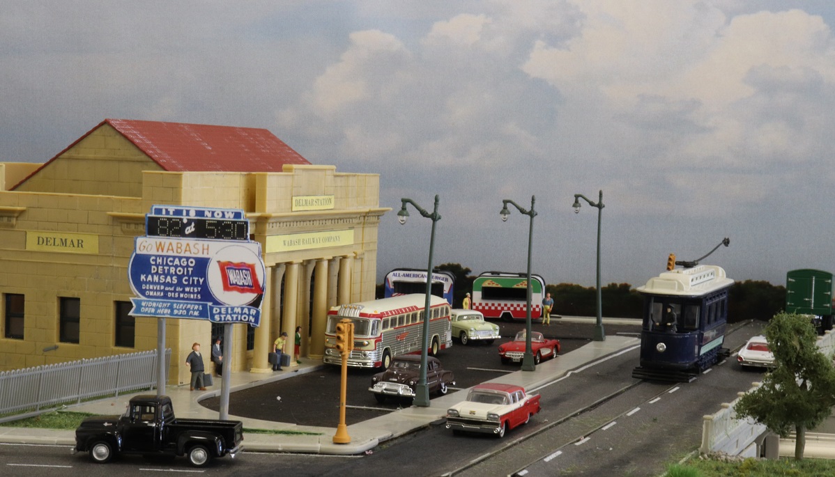

I bashed this St. Louis Delmar Street Station from two “Baily Savings and Loan” kits. Proved to be a bad idea because the hollow moldings didn’t cut and fit together well like they would had they been solid.
I don’t want to build these kits and have cookie cutter versions of what everyone else has. It would be nice if Walthers had an add on set of castings that allow easy extension of the walls between the same kits allowing easy building of more realistic structures.
