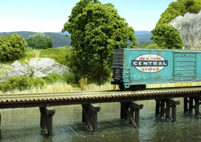

True, but not necessarily. The trees in the background of this photo are puffballs.
And my puffball trees really aren’t even very good

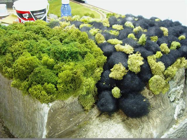

I tried a variation of puffballs and lichen to break up the uniformity. Not spectacular, but I thought it turned out okay:

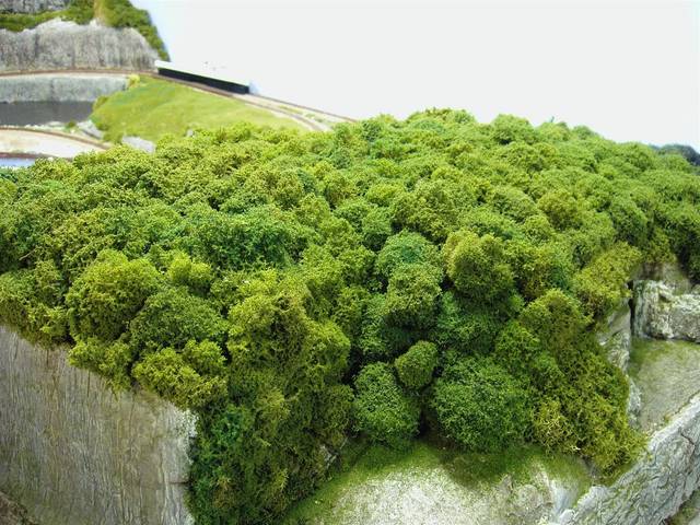

Supertrees look far better alone or in clumps:
