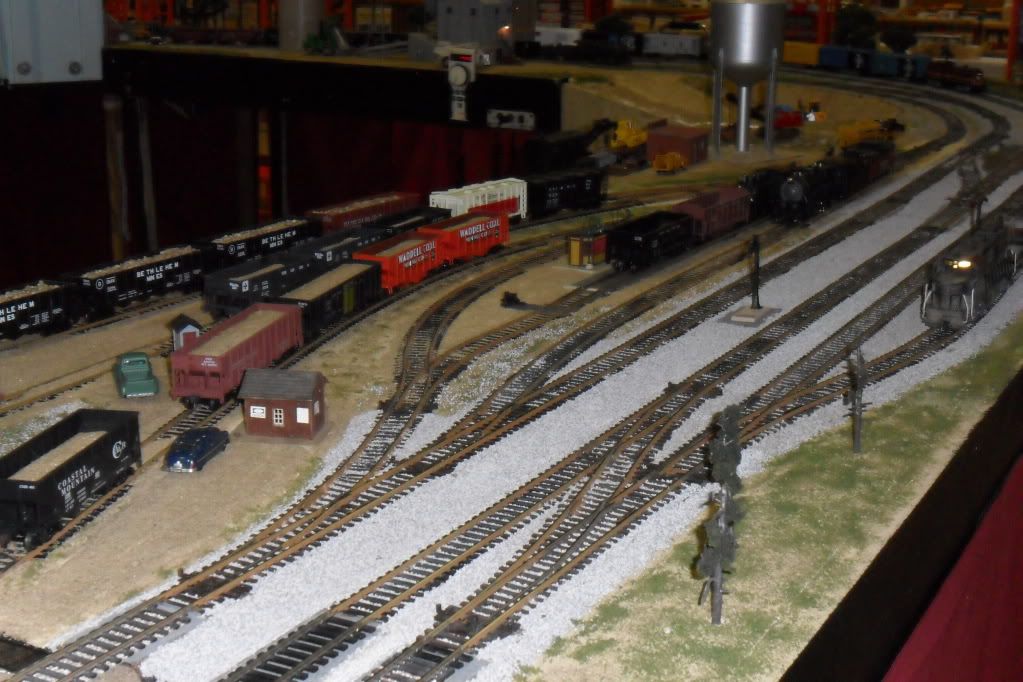

The beauty of modules is that there are no set configuration. One thing is that you don’t build curved modules but instead use a corner module that can have a rounded front edge. If you double up some plastic wrap between modules when doing the scenery the modules will not be glued together but the scenery will be seamless. (ask me how I know this [:$] ) Why go with 18 and 22 inch radius curves? My module has 42 inch curves and is only 4x4.
Believe it or not there is a seem running from front to back just under that standing steam loco.
http://i1081.photobucket.com/albums/j348/locoi1sa/SAM_0115.jpg
Hear is my corner with the wide curves in the back ground. My modules have been through heck over the ten years of doing shows. Hurricanes, Snow storms, Rain, Wind, freezing cold, and rough roads have taken its toll on not only the modules but the owner too. They are now retired and happily part of the home layout.
Pete
