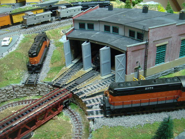

I really didn’t have a good shot of the roundhouse, so I took one. I just finished up the scenery a couple of weeks ago, so I wanted to wait until I at least eliminated the pink parts.
I replaced the plastic “foundation” pieces from the kit with hydrocal castings of a rock wall. The non-functional lights over the side doors were replaced with working ones from Walthers.
