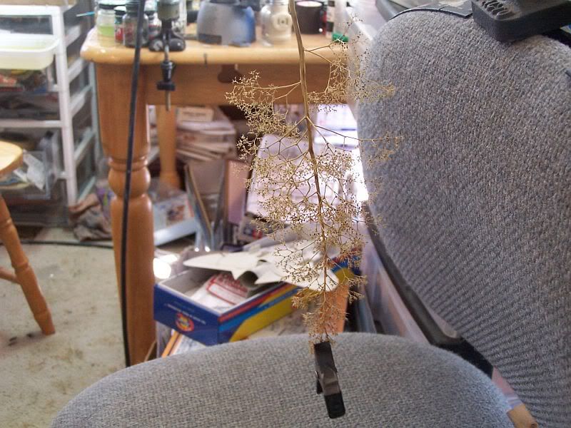

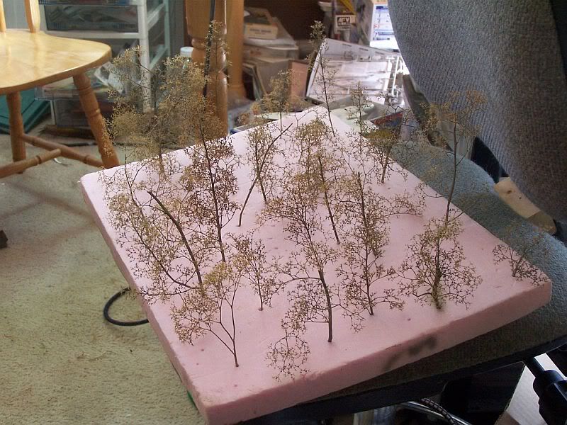

First is a shot of the armatures ready for foliage to be added. Extraneous material has been removed and the armatures have been straightened somewhat and painted gray/green.
This is a picture of a longer armature that was really curled. I did the recommended soaking in warm water for about 30 minutes and then hung it upside down with a weight attached. I let it stand about an hour before removing it and painting.

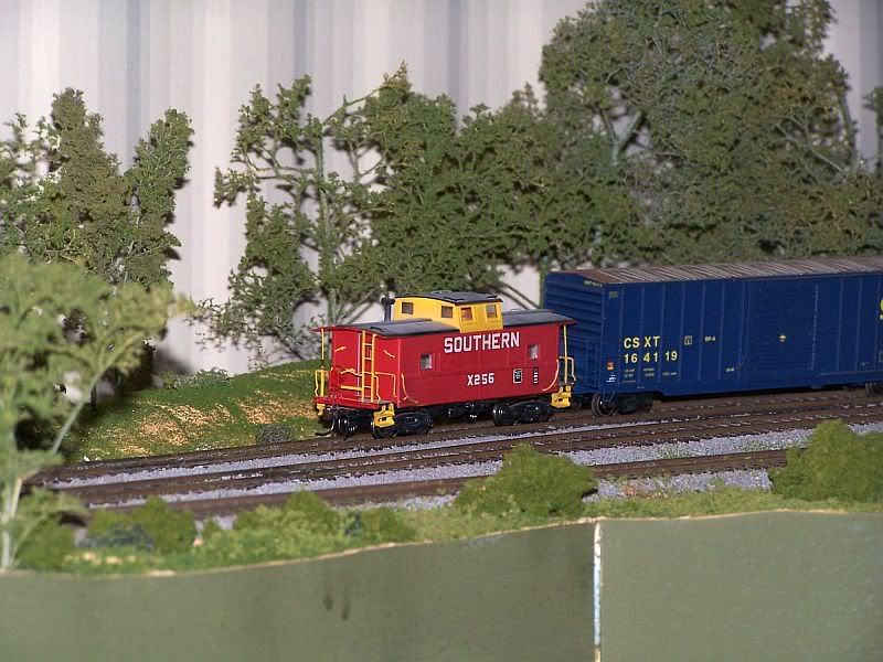

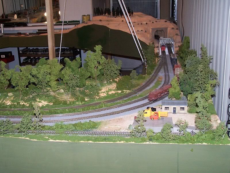

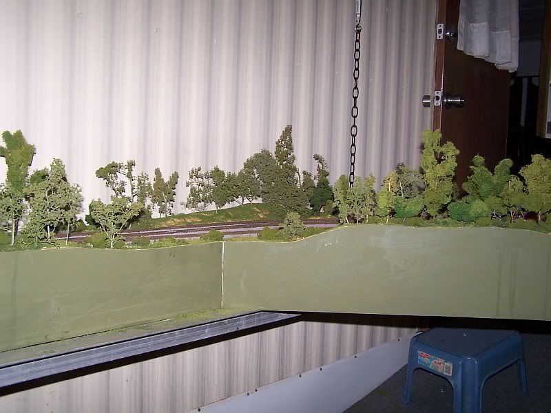

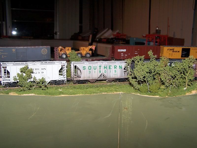

After spraying the armatures with hair spray, one of my friends prefers to use 3M spray adhesive, I just sprinkled a combination of coarse turf and blended turf allowing it to stick where it wanted to. The following images are the final results.

How do you straighten the trees? I’ve soaked them in diluted matt medium for an hr., hung them upsidedown with HEAVY washers clamped to the tips & they return to their original shape after hanging straight all night.
Jerry - Simply dipping SuperTree armatures in diluted matte medium and hanging them up, almost regardless of the weight added, won’t straighten the trees. They must be boiled for 20 minutes, or so, to first make them supple. Immediately after removing them from the hot water, you hang them up side down and add weight to the inverted tips until they do hang straight. Then leave them to dry.
Once dry, then you dip them in the diluted matte medium, shake off the excess and re-hang them (without any weights this time) the same way to dry again. Once they are again fully dry, then you can start applying your ground foam “leaves”.
