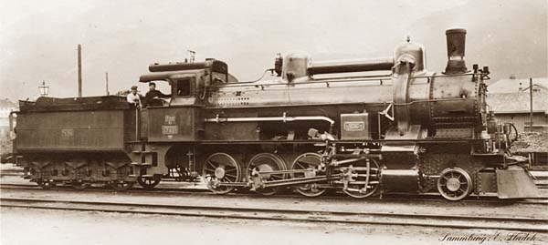

An extreme example, maybe, being the Golsdorf locos with the external steam-pipe running forward from the steam dome. Uggggly.

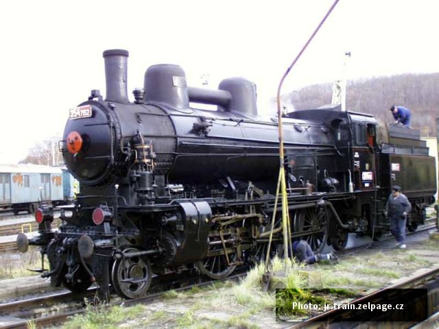

That caused me a bit of head scratching, AP. Are you referring to the pipe between the domes, or the pipe from the dome down to the valve chests?
The pipe between the domes is, as you suggested, a steam drier.
As to whether it’s ugly, that’s a subject to discuss another day…
Sorry about using CSD engines as examples, but good clear photos of kkStB engines seem to be rather thin on the ground in cyberspace! But while I was searching I found these, you might find them of interest.

mn:
The one between the domes. I confess that I never noticed the other one, having only seen the loco in question (one of the compound passenger types, in one of Brian Hollingsworth’s books) in a small photo, which may have been from the other side. As for ugly, that is indeed in the eye of the beholder, and the engines shown are actually quite handsome in that businesslike Teutonic way. Definitely not engines for guuuulie men. But this beholder just sees that steam pipe and thinks “hey, a Paul Bunyan-sized carrying handle!”
So it’s a steam dryer? How does that work up there? I always assumed such elements needed to be surrounded by hot combustion gases or perhaps highly superheated steam as a heat source. Some sort of mechanical droplet separation going on? Those crazy Austrians.
